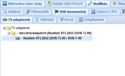

    I have a Qodi Tap 1 box (Beelink, S905x, 2GB) and an Astrometa tuner. I cant able to use with LE8.2.3.1, after reboot it visible but cant able to tune, and after then only the SDR part staying and others are gone...any hint? Im speechless.
    With dvb-fe-tools it visible and able to change mode, but cant see in tvheadend....
