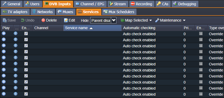

    Hi, i have kinda problem with tuning to DVB-T2 HEVC Mux with strong signal on Xbox One tuner with Tvheadend. On Linux it works perfect, no drops, stable signal. Also on S905x box it works with no problem. I just want to receive Mux and pass it on another device, or record it. No processing on RPi. Every channel is in h265 (hevc).
    But on Raspberry Pi 3B+ it just either wont find any DVB-T2 mux on Tvheadend or just see there is something but... look at the screen. All i did was installing from repo and configuring.
    Edit: DVB-C tunnig also failing, this time 100% fail rate :D
    Any idea what to do? Thanks
