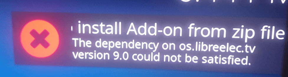

Hi afl1, same problem here. Please check image attached in last version of libreelec (8.2.2.3): "the dependency on os.libreelec.tv version 9.0 could not be satisfied".
Regards.
