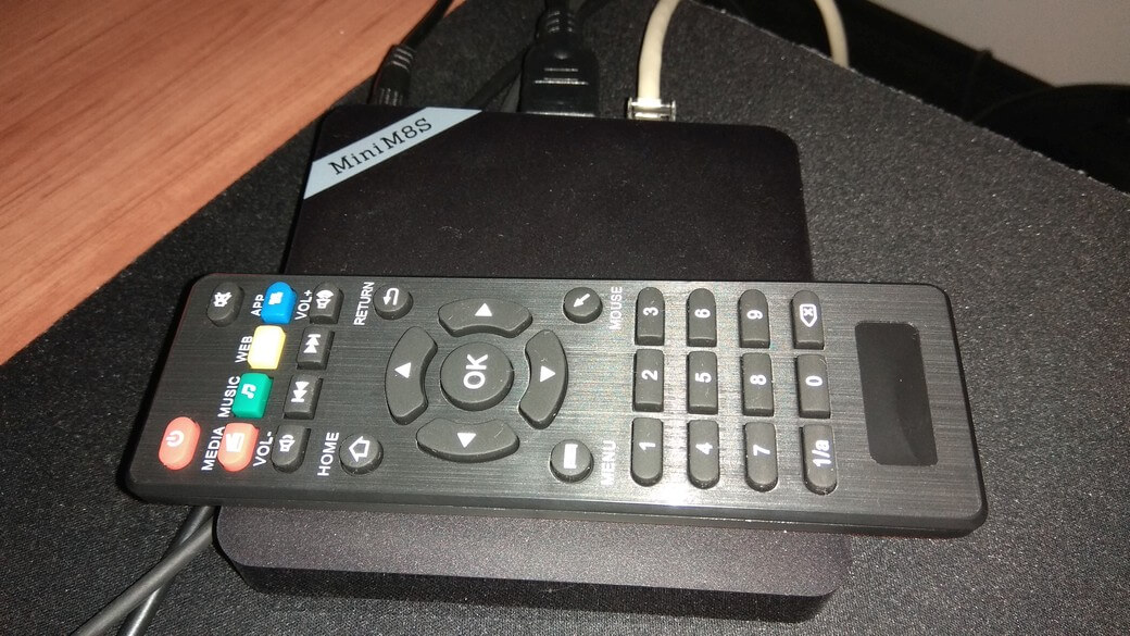

    mini_m8sII:
    # table mini_m8sii, type: nec
    0x8030 KEY_NUMERIC_0
    0x8031 KEY_NUMERIC_1
    0x8032 KEY_NUMERIC_2
    0x8033 KEY_NUMERIC_3
    0x8034 KEY_NUMERIC_4
    0x8035 KEY_NUMERIC_5
    0x8036 KEY_NUMERIC_6
    0x8037 KEY_NUMERIC_7
    0x8038 KEY_NUMERIC_8
    0x8039 KEY_NUMERIC_9
    0x8051 KEY_POWER
    0x804d KEY_MUTE
    0x8053 KEY_HOME
    0x804e KEY_VOLUMEUP
    0x8056 KEY_VOLUMEDOWN
    0x80bb KEY_FASTFORWARD
    0x80bd KEY_REWIND
    0x8058 KEY_STOP # 1/a button on remote
    0x8026 KEY_UP
    0x8028 KEY_DOWN
    0x8025 KEY_LEFT
    0x8027 KEY_RIGHT
    0x800d KEY_OK
    0x8044 KEY_BACKSPACE
    0x8009 KEY_RED
    0x8011 KEY_GREEN
    0x8054 KEY_YELLOW
    0x804f KEY_BLUE
    0x8049 KEY_MENU
    0x801b KEY_BACK
