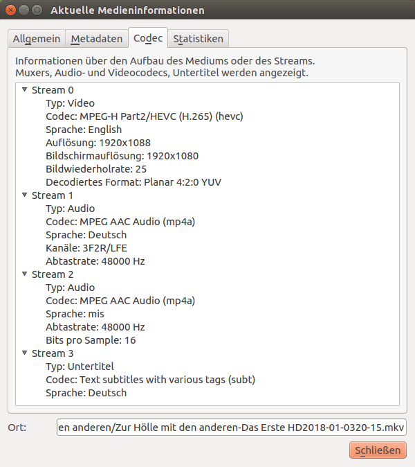

My problem is the following: Whilst I can watch all programmes without any problem, I have problems when I record movies of ARD that are distributed with 2 channels, one with 5.1 AAC original track and a second 2.0 stereo track with audio description and play-back them again.
However it is no problem to watch the movie with live tv. But when I record such a movie and play it again, the picture freezes as soon as the movie starts after "Tagesschau". Only if I switch to the audio description channel, the movie is played. This problem occured tonight, when I tried to watch "Krügers Odyssee" from ARD from my recordings.
Why is there a difference between watching and playing-back? Is there another player used? Or is there a special goblin inside, if the movie is too funny?
Do you know how I can solve this problem? It occurs especially on ARD at the 20.15h movie on wednesdays and fridays.
