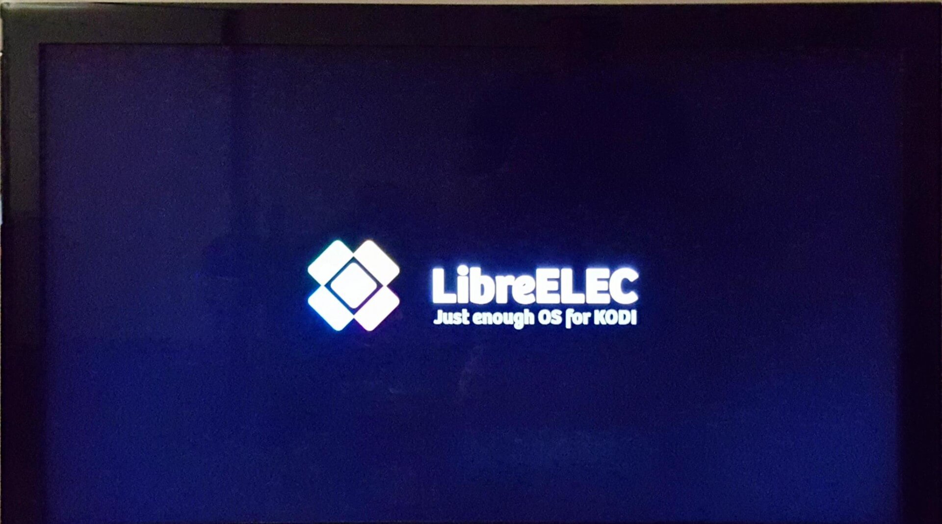

That's it, no Kodi on the laptop screen and only a LibreELEC image on the TV.

Also I added two foto's showing the result (notebook screen and TV)
The foto of the TV isn't showing the 4 colors of the image as I can see them, believe me the colors are there
