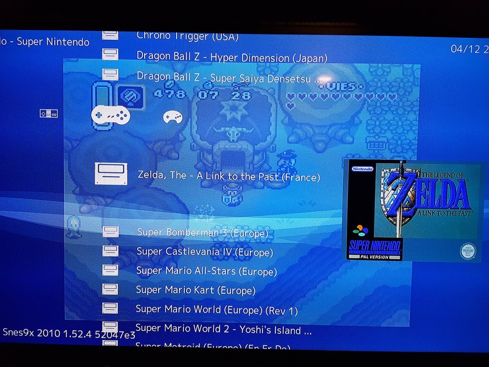

Maybe a compilation issue ?
I remember another user had same issue some months ago but I don't know If he/she could solve it... Did you try by changing xmb background opacity? You can change background color and check if thumbnail color also changes. Did you try using thumbnails instead of boxarts?
I really don't know, these are just the firts things that came to my head...
maybe lollo78 can help us
Thanks for your answer.
I have allready tried this changes before posting, nothing work...
The problem is not related with the background.
Hello,
First, thanks for your great addon.
I have migrate my old Gamestarter addon to the new repo.
I have delete all old folder, and after reconfigure retroarch, the emulation run fine.
My problem is with the library in retroarch. The boxart don't show correctly, the boxart is "blue"
My picture in attachment show this problem.
I tried some modifications in the configuration of the interface, but nothing solve this.
Can you help me ?
