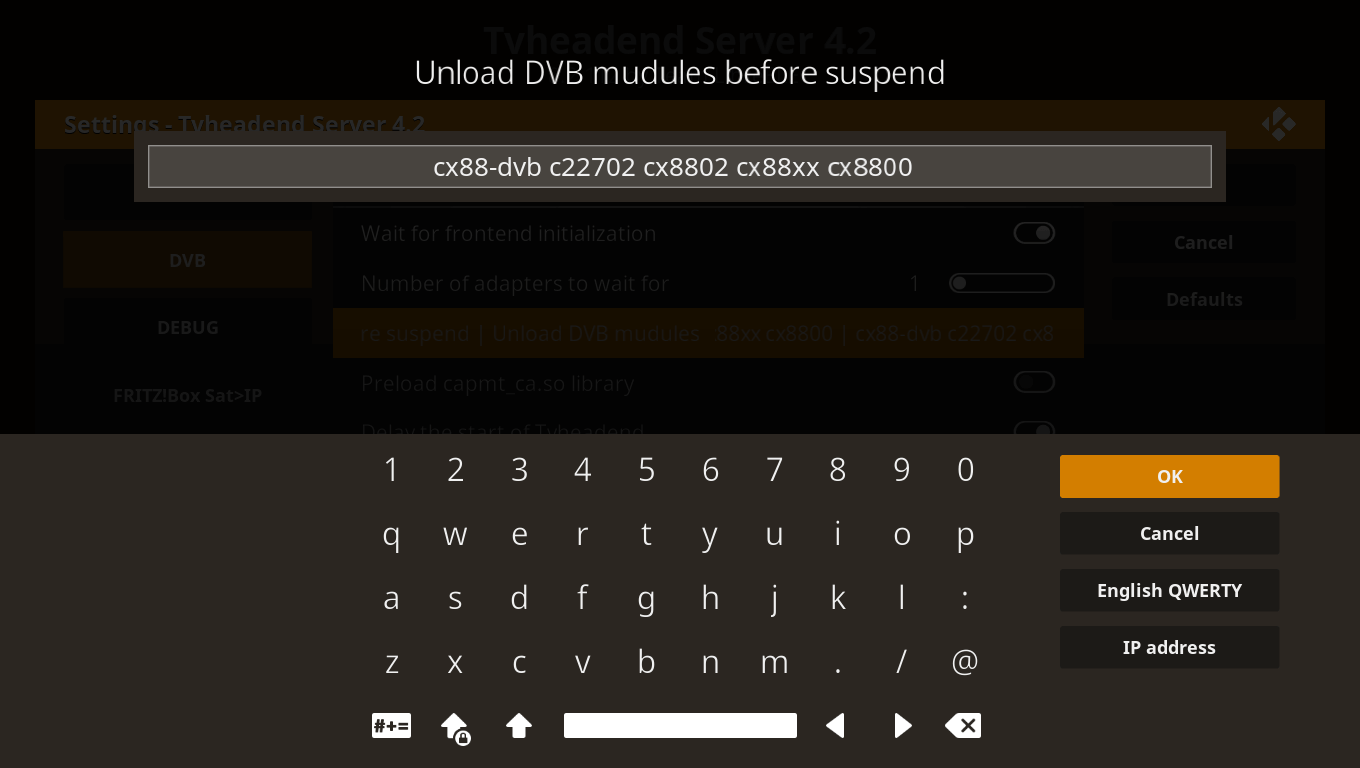

Thanks CvH - I have this working now.
For anyone else with an HVR-3000 (or any TV card with the Conexant CX-22702 chip), the modules to unload in the TVheadend addon settings are shown below:
Note, you need to list them in the right order.
I found these the easy way on this page:
Hauppauge WinTV-HVR-3000 - LinuxTVWiki
Sam

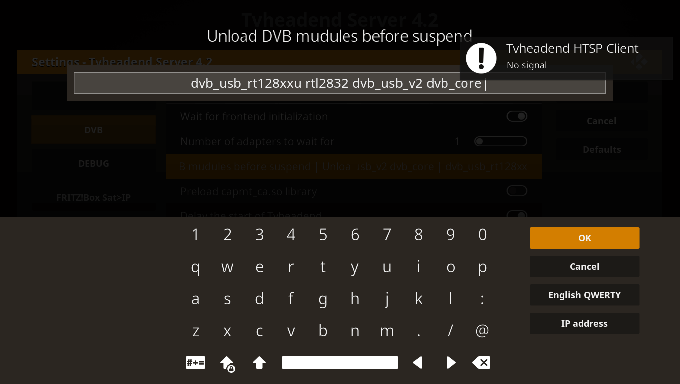

Hi
I have the same issue:
Problem: I have a PC running LibreElec and TVheadend. All works fine, but when I suspend and then resume, there is no TV signal. Message: 'Tvheadend HTSP Client No Signal'. It's fine when shut down and restarted.
I've followed the instructions above and entered the following modules into the TVheadend unload list - see screenshot:
But still no good. Any ideas?
Here's my set up:
LibreElec: 8.2.1
TVheadend 4.2.3-20 (Libreelec Tvh-addon 8.2.112
Conexant CX22702 DVB-T
Debug logfile: Ubuntu PastebinAny pointers gratefully received. Thanks!
