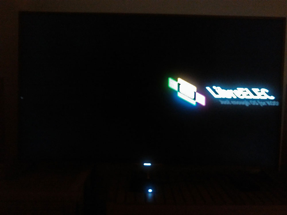

Sorry, this is correct link for the latest test version: LibreELEC-S905.aarch64-7.0-devel-20160823222143-r23289-g475b5e8.tar
I've rebooted to android, set the resolution to 2160p60, then rebooted back to libreelec with this version.
First I can see the bear logo (was it here before?) for a few sec then comes the libreelec logo but a little distorted (see the attachment) but it is full screen not quarter and according to the tv it is 2160p.
Is there any chance for LibreELEC boot to set screen resolution to 1080p and later switch to 4k.
Seems that even though it starts in 1080p, LE sets 4k sending an incorrectly sized splash. During boot (LE Logo) TV reports boot resolution as 4k.It is just annoying to see 1/4 screen boot logo.

This depends on screen resolution configured in u-boot. I guess you see LibreELEC logo at 1080p/720p screen resolution and then it switches to 4K?
Yes, LibreELEC starts in 1080p60 and then KODI switches to 2160p60.
GUi is now working, but LibreELEC splash screen still shows on a 1/4 screen.
Interesting. This never happened on my MINI MX-G. Have you experienced this with the original 006 version too?
In the 4th test build I fixed 005's approach to render GUI at 1080p and then scale to 4K. I think in your case scaling does not enable for some reason at boot, I will revise my patch and post a next test build, hopefully the last one.
