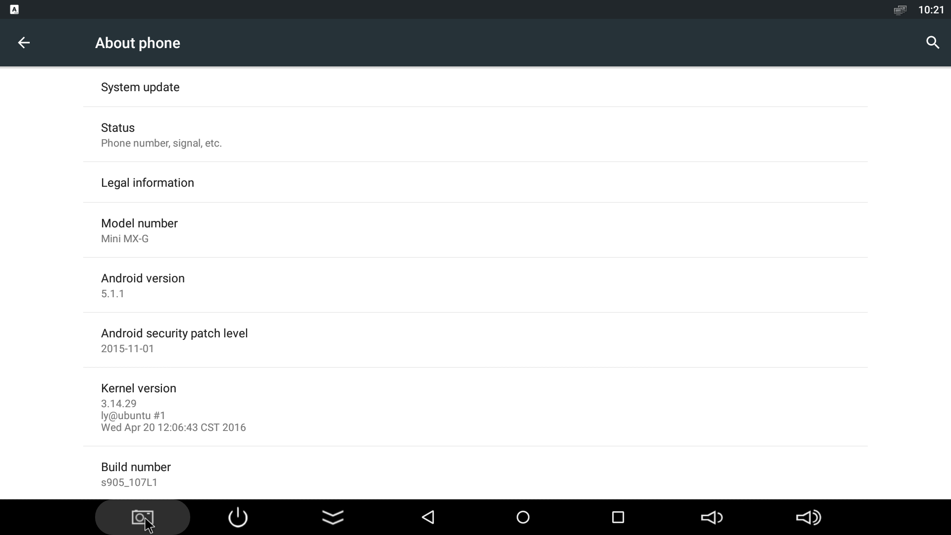

Could you check your android system info instead of this screen?
Display MoreI am a little confused and stand to be corrected in that i believe there is no such box as an MiniMxg 2g/16g.
The g after MiniMx has thrown me in trying to locate a device tree similar to my MxMax.
The specs of the MiniMx 2g/16g are similar to the MxMax . I then presumed the MiniMxg was in fact
Just a MiniMx 2g/16g so i used it. It did work however a Google search for MiniMxg 2g/16g failed to locate such a box
for me to compare specs. Can someone confirm the box image i have inserted is in fact referred to as a MiniMxG
in the device tree downloads ? The image is in fact just a MiniMx 2g/16g
The MINI MX ver. 1.0 (2GB/16GB) calls itself MINI MX-G.
You can see it in the android system info.
So I think MINI MX-G is a proper name for it and easier to use than MINI MX 2GB/16GB
