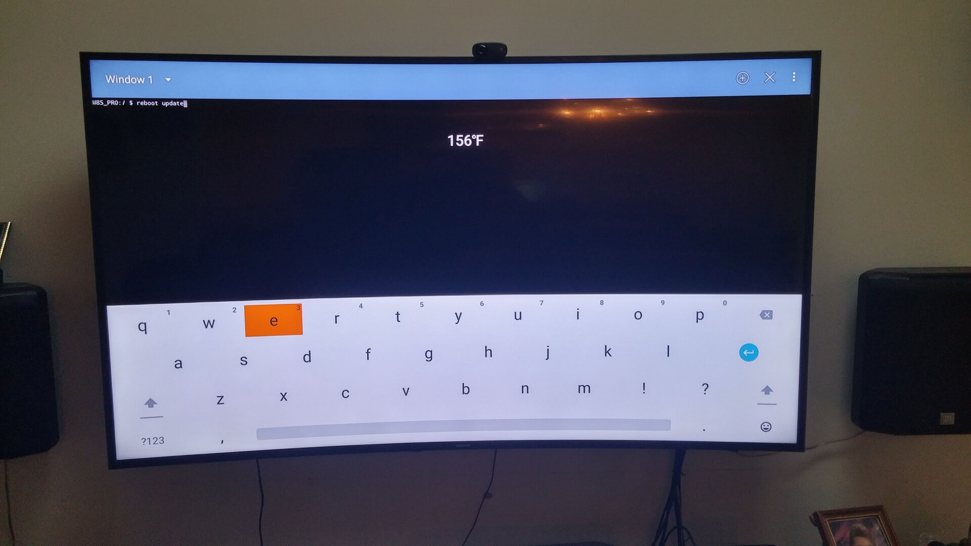

So I have installed the terminal. Previous to that flashed LE to memory card and also copied the dtb.img from device tree. Im having issues in rebooting.
$pwd
$/data/data/com.termux/files/home
I do reboot updateIt says "No command reboot found"
From where should I run this?
Note:- I only copied the remote.conf from Index of /MECOOL/ as mine is pro L
When you open your terminal app, it should look like this after your type "reboot update" . If you used "Rufus" or similar app to create your bootable LibreELEC microSD card, and have it inserted into your M8S Pro box, it will boot right into the LibreELEC install, after you click the little "blue" button on the onscreen keypad.
