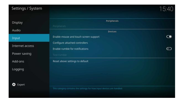

i just installed LE9.0.1 teh stable version . and also at peripherals ...empty

also with a new install, at Settings -> System -> Input -> Peripherals is still empty
i also now have a GRAB FANART ERROR, at start up
mmhh also a fresh new install is not fixing my issue
i checked that section peripherals, but it is empty on my system, so i think i have no CEC adaptor installed
