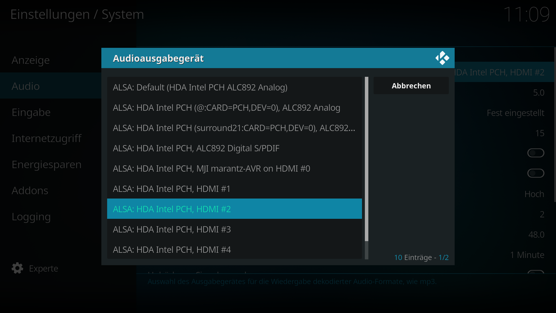

I checked and there is no Bluetooth present or configure from the user side.
The real problem I see ist still the question : Why does LE forget my setting and witching to another audio output, to some HDMI, that is not present, while at HDMI #0 the correct AVR "Marantz" is detected and shows the screen correctly ...?
Anybody can help me?
Thanks,
/BJ
Hmm,
that means : I have to deactivate/deinstall the Bluetooth output ?
I will try..
/BJ
Hi,
I am using LE 8.90.007 on a new J4105-itx. Whenever I start LE the audio output is set to HDMI #2 and I have to change it manually to #0, where the options show HDMI #0 connected to my Marantz AVR.
I have read a lot about the edid thing but I don't think it is the reason here. The problem occurs always ! Regardless if AVR and TV are on or off. I have also switched to "fixed" on Output Configuration, doesn't help.
What makes LE forget my selection?
/BJ
