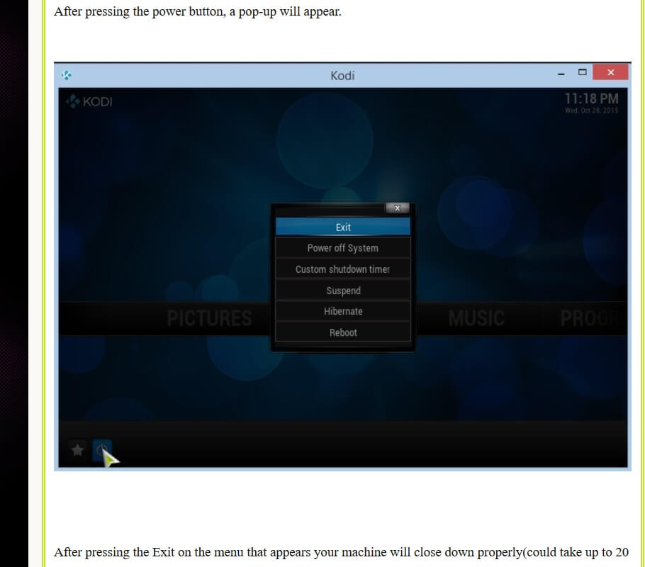

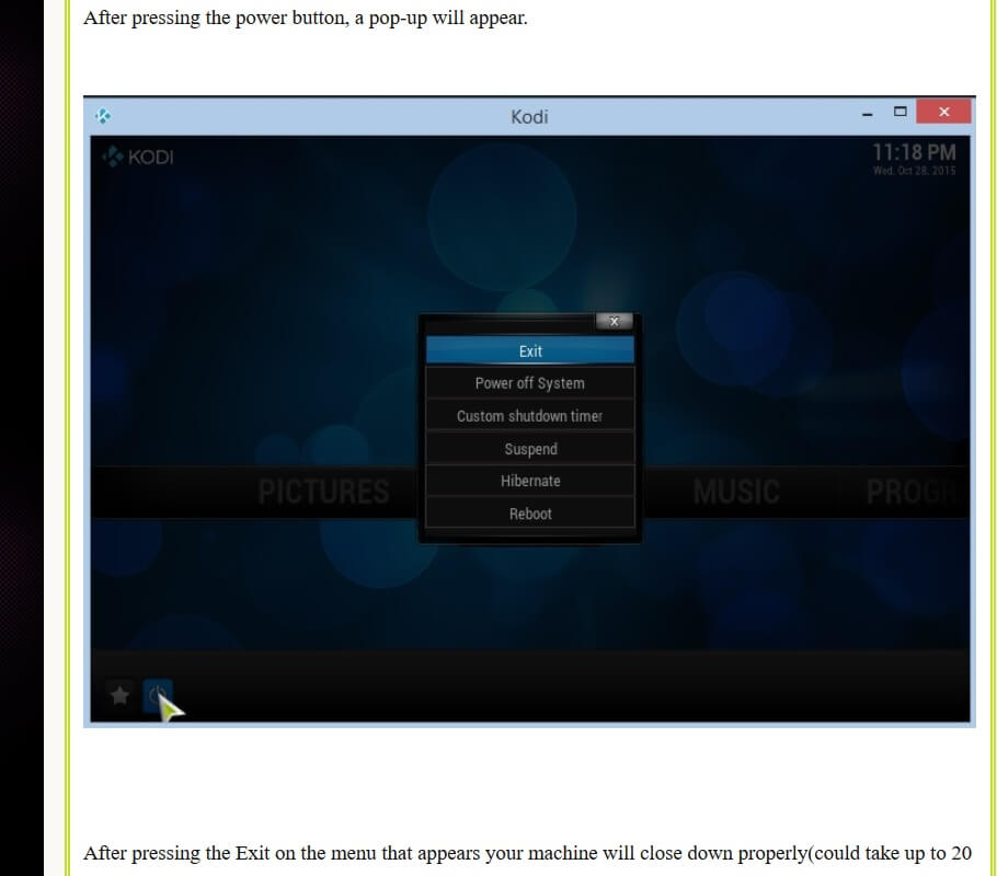

Hi. I've just put LibreELEC/Kodi onto my S912 box. Prior to that, I could put the box into standby (green light) or off completely (no light). With LE/Kodi, I can only go as far as 'green light' but it would be nice to be able to have the full shutdown option. It seems possible according to this which I found on the web:
I have the same skin as the image but my options are only Power Off System, Custom Shutdown Timer and Reboot.
'Exit' seems to be the one I want - is there any way of getting it? Thank you.
