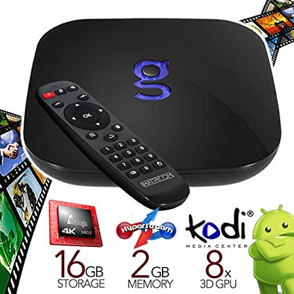

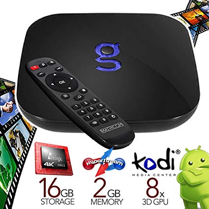

Going to try this Again I have one of these Matricom G-Box Q² Android TV Streaming Media Mini PC [2GB/16GB/4K] Quad/Octo Core, BUT it was the first Gen Matricom G-Box Q Specs are all the same buy has a S802 CPU I programed it with LibreELEC M8 it's a 8.2.5.1 Works Perfect, I bought a Few of The Q2's I be leave everything is the same BUT has a S812 CPU when i tried to program with M8 Brick's the box I have played around with a few Different Versions of the s812 Software only one i found that half way works is the M8S Plus but the remote don't work and the network cat5 tree is wrong Wifi does work, I have got The remote to work but not the cat5 Settings are correct in The networks settings I see that People on her have these boxes but never found what LibreELEC version of software works for this box, Thanks

Or do you mean S812 CPU 8-Core Android 4K TV Box [2GB Ram/16GB HDD
Mali-450 Octo Core 3D GPU Graphics Processor
I will try it's a Matricom g-box Q2 that's what they call it First was the just G-Box Q 802 CPU then they came out The Q2 Version it has a 812s CPU
I have never owned a Q3 comes with Android Nougat 7.1 S905xx CPU
After Reading on here Alot I'm Still a little confused on what is the Right LibreELEC Software is, I tried the LibreELEC-Amlogic.arm-M8-8.0.2 Works Perfect in The 802 CPU BUt will brick a Q2 with 812 CPU, After Reading I tried The LibreELEC-Amlogic.arm-M8SPlus-8.2.5-update it loads and works but the remote doesn't also cat5 internet does not work Wifi does i let it take an update it wanted to install x8 Version went into endless reboot
