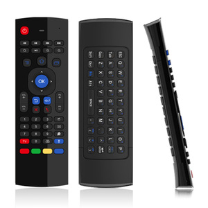

This problem continues with V9.0, running on a RPi3. It relates to the M3 2.4G Wireless Remote Control Keyboard Air Mouse, a picture of which is attached.
To restate the issue:
It appears that support for this device was added in version 8.90.003 and worked correctly until 8.90.005.
From 8.90.006 onwards, the 'cursor' mode works, but when out of 'cursor' mode, it appears that device arrows keys are being pressed continuously, and the menu buttons flash on and off on the screen seemingly randomly.
I have tried using the airmouse with the latest released Windows version of Kodi (v18.0), and it functions correctly.
I attach a debug log on a clean system. The only action I took was to press the 'cursor' mode button to take it out of the cusrsor mode. After that the Kodi main menu buttons flicker on and off at high speed, as if the up and down arrtow keys were being pressed.
I have tried using the airmouse with the latest Windows version of Kodi (RC3), and it functions correctly.
Any ideas?
