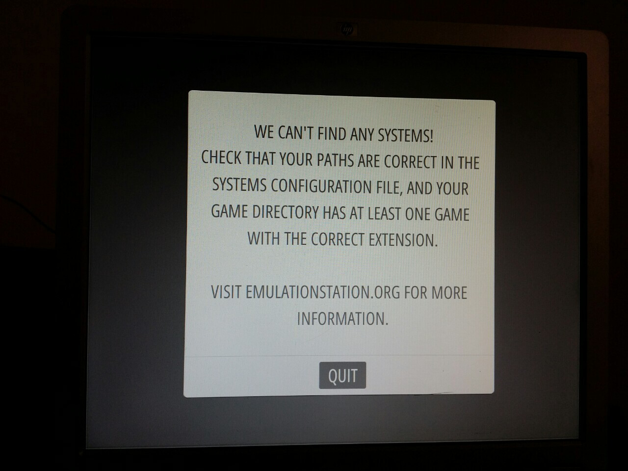

ok. According to that message you have no rom in /storage/roms/xxxx folders, right? If so everything is ok.
Putted some roms in /storage/roms/ and /storage/emulators/roms - still the same. Didn't get it about "/xxxx" folder. Is there must be a subfolder named like NES or SEGA or something, I guess ?
could you please install and launch emulationstation addon? I just wnt to know if it works, if it does you can uninstall , that's all.
No problem. I've tried it before, and right now after 8.167.2 update. It starts and shows message - watch the attach.
