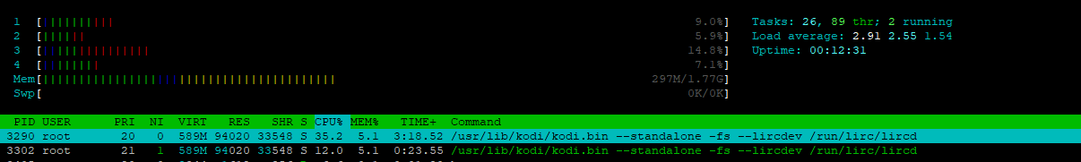

Check CPU usage in htop.
Why is lircd is the top CPU consumer despite Lirc is disabled LibreElec settings? -

If that is lirc remote control thing, I have it disabled in LibreElec options already.

btw afl1 , in htop I saw that mount.ntfs has high cpu usage(as I expected).
Changed the file system to exfat(sometimes I need to use it in windows as well). CPU usage is fine now.
But I saw lircd using a lot of CPU as well. What is that for? Can we disable it? -
