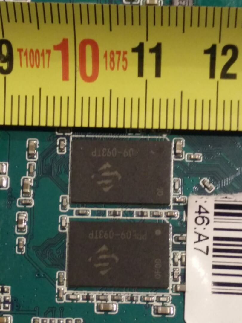

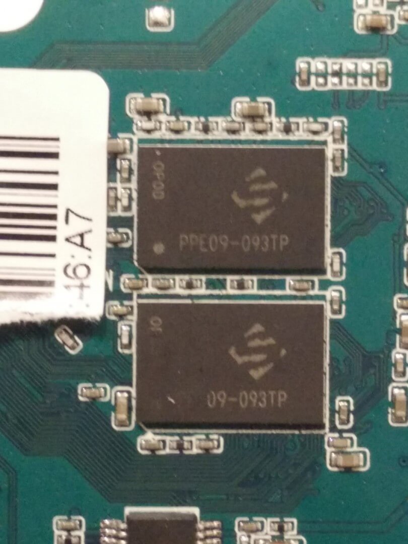

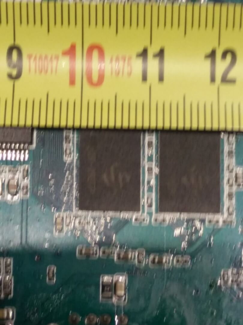

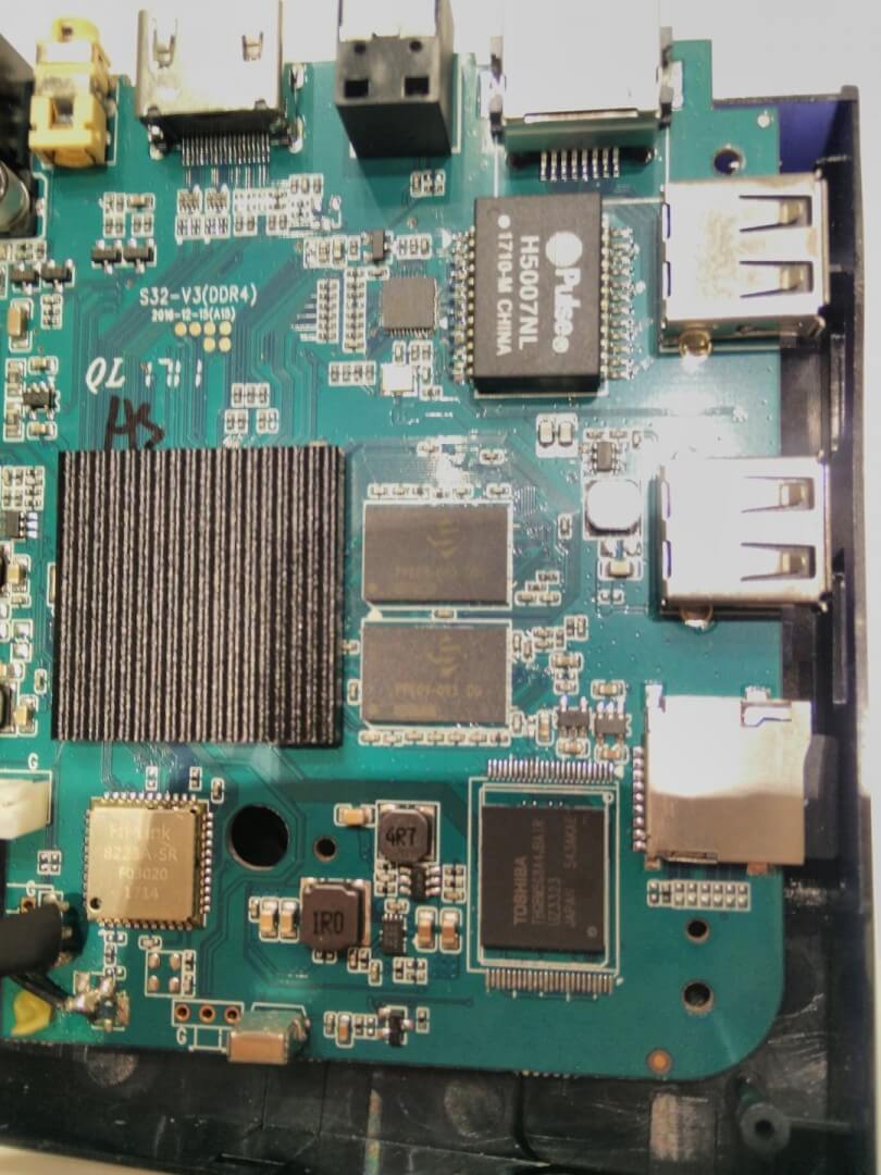

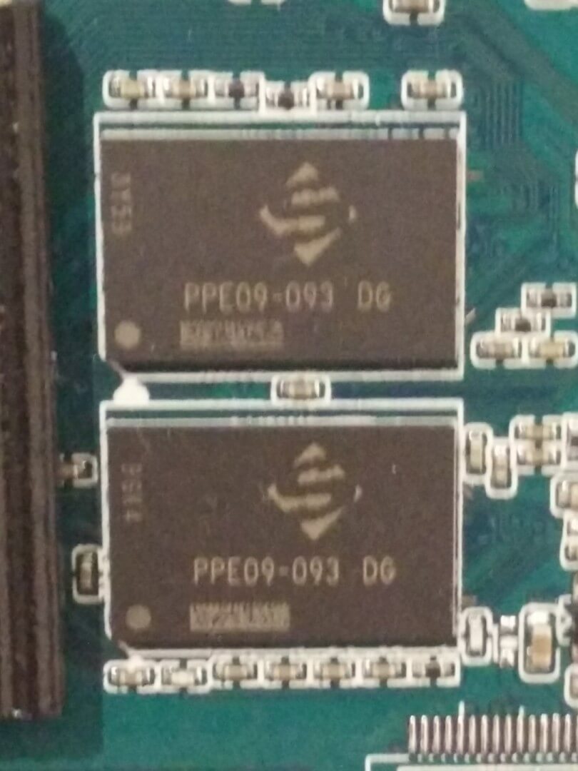

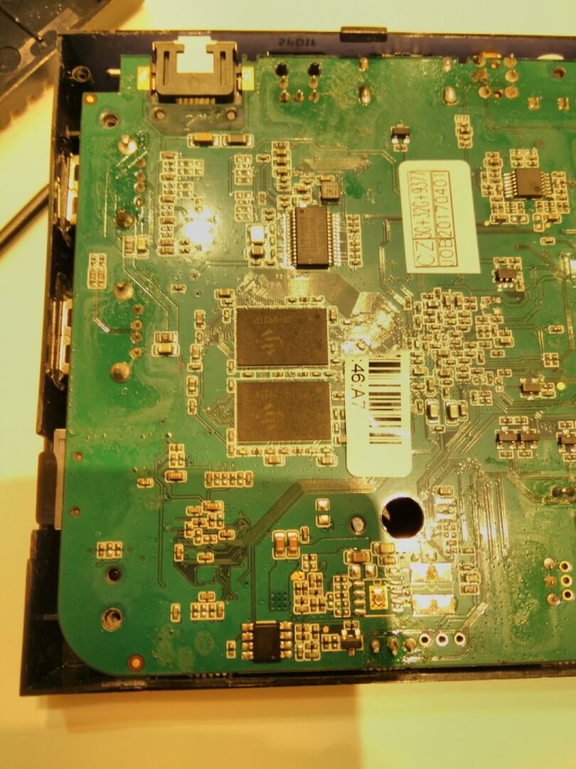

    Rank1 (1024MB) could not be initialized, i will see what I can do.
    What is the size of the single RAM chip - 12x8, 13.2x9 or 14x9 mm? Please measure on the front and on the back of the PCB.
    Ok,
    size is the same on front and on back side, and is 14mm x 0,9mm,
    Attached there are some photos (chip on front side have different ID of back chips).
