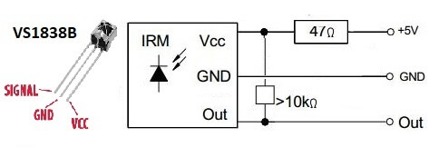

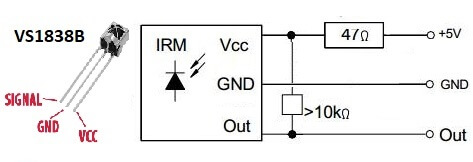

I've been trying to make it work, but I do not get it, I thought it was the sensor's fault, but it works perfectly on an arduino with 3v voltage, I tried it again in raspbian and I did not get it either.I used ir-ctl -r to see if the sensor responds, the truth is that it responds, although very badly, when I point to the command it almost always does not respond, only sometimes, I would say that it is broken if I have not seen it working in arduino later
Can it be the sensor or is there a bug with lirc?
What similar sensor do you use that works?
Sensor: VS 1838B
Libreelec: 8.2.4
Raspbian: Stretch
Infrared Remotes [LibreELEC.wiki]
-----------------EDIT----------------
I put the vcc of the ir reciver on 3v3 in arduino and work, but when change the vcc to the 3v3 in raspberry, not work.
what can I do to make it work in 3v3 on raspberry pi ?. Any way to stabilize the circuit ?
