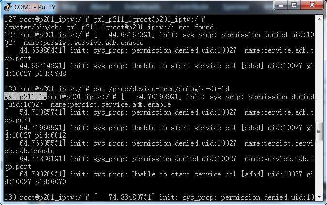

The DTB you attached contains device trees only for 1GB and 2GB RAM. I guess you have only 2GB of RAM. It also has some unknown (to me) boards: gxl_p211 and gxl_p215.Can you tell me which device tree is used by your box? You can check it running this command in Terminal Emulator in Android: cat /proc/device-tree/amlogic-dt-idMy box is gxl_p211_1g, it can not be supported for now, right?
The file you posted includes gxl_211 and gxl_p215 boards device trees. Unfortunately these are not available in Amlogic sources.
If you use Amlogic Customization Tool, you should be able to extract dts files from that firmware. That would help a lot.
No, I can not extract dts files from the firmware, it says no dts file available.
