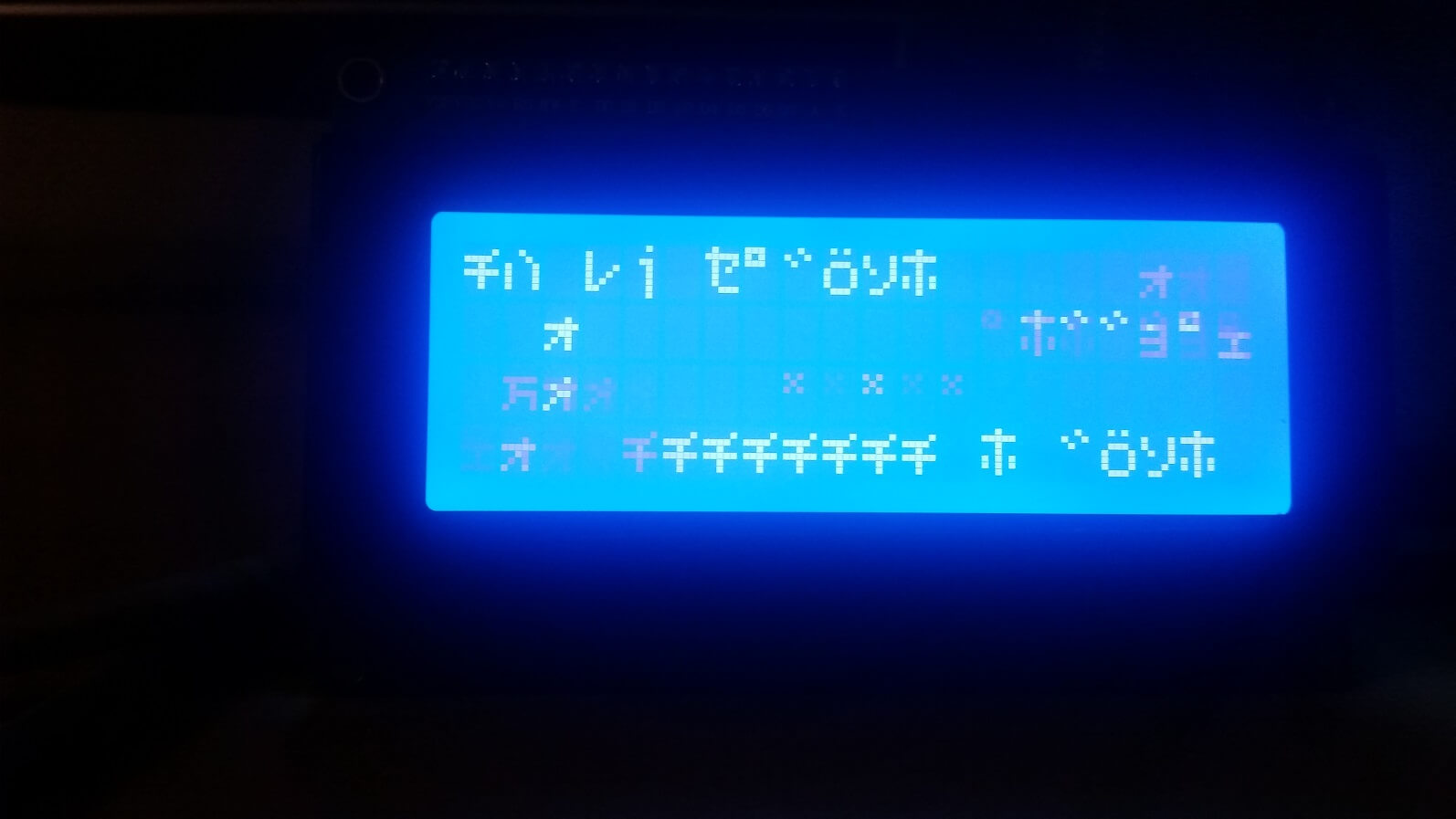

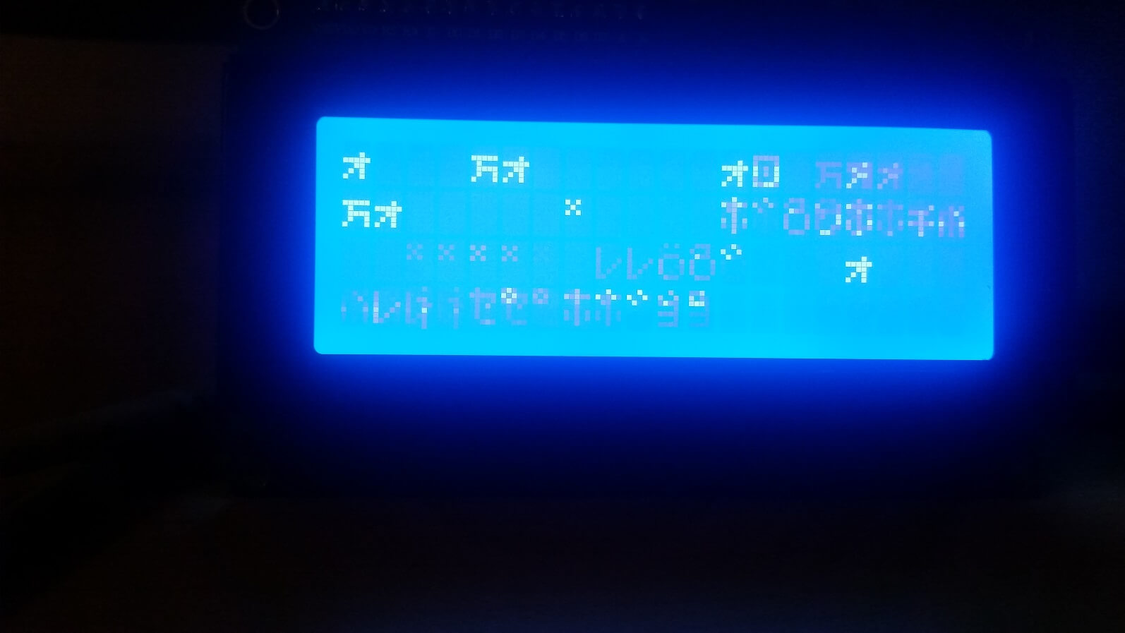

I am not getting a welcome message and the display looks like that:
What ist wrong? Please help me!
