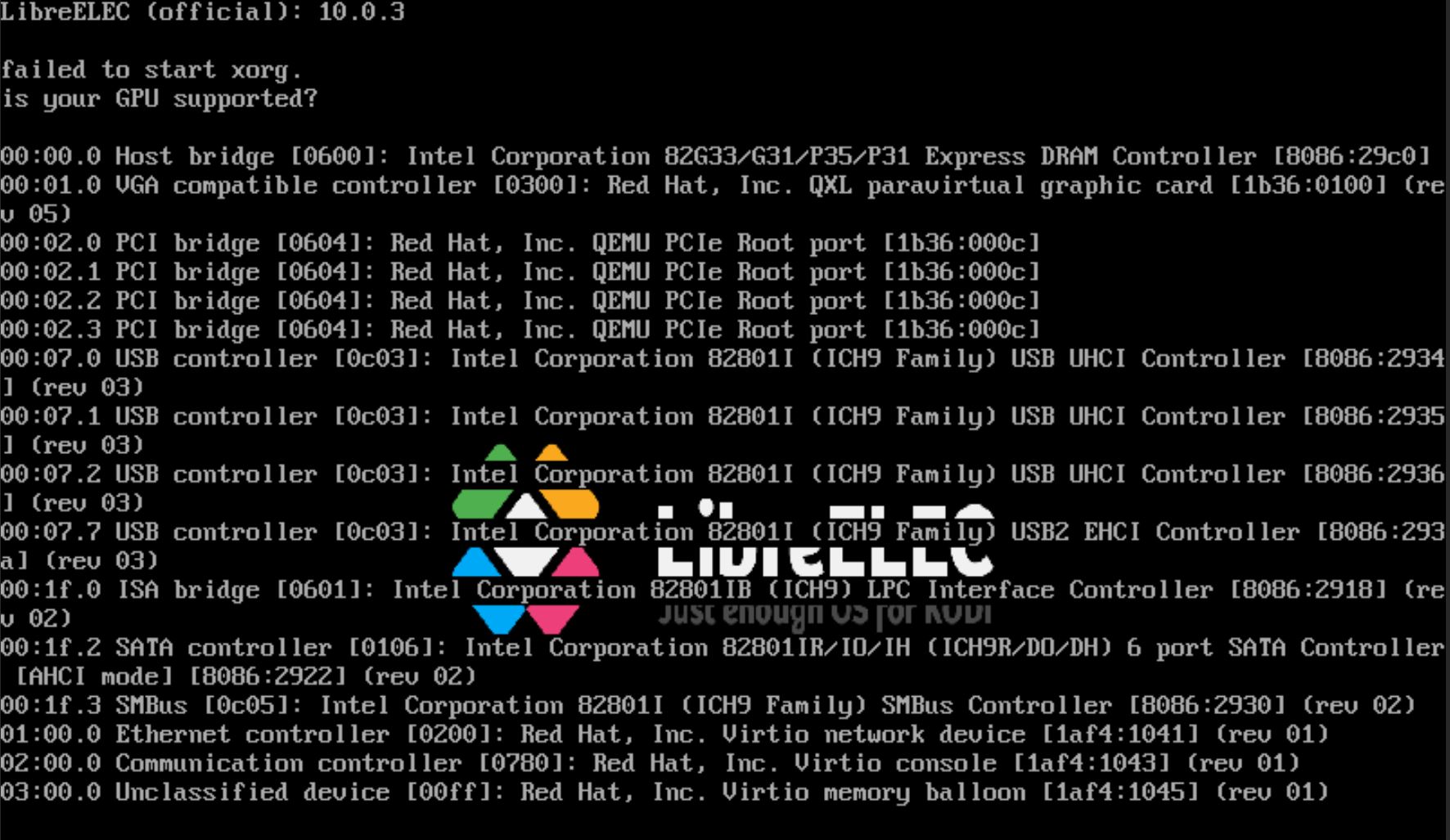

Hi,
I have a strange issue thats's driving me nuts.
Been using LE 9.2.6 with Kodi 18 for years now and was looking forward to do the jump to LE 10.0.3 with Kodi 19 over the christmas days.
I'm running LibreELEC in a virutal machine on my unraid server with the following hardware passing through my GT1030:
- ASRock H570M-ITX
- Core i5-11400
- Geforce GT1030
I built up the VM from scratch to have a fresh Kodi Matrix install.
What I get is the following message that my GPU is not supported:
That's strange because I get this message after installing LibreELEC using VNC. When I assign my GPU the screen just stays black.
I don't have this problem with LibreELEC 9.2.6
And it doesn't matter if I'm using unraid 6.9, 6.10 or 6.11.
BUT... when using unraid 6.10 or 6.11 also LibreELEC 9.2.6 is NOT working anymore.
So I'm trying to understand what's causing this issue?
I'm not getting support here on the unraid forums until now so maybe someone can point me in the right direction here ![]()
