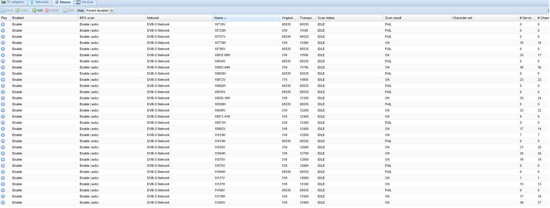

    Hi I have a problem with my laptop and DVB S2 DVBSky 960CL. I have installed the Libreelec and TvHeadEnd. When you scan with part of the mux error appears. Also a lot of channels, mainly from the Polish provider "Cyfrowy Polsat", "NC+".
    Anyone know why this is happening? KII Pro with Libreelec all scans well. With this configuration on my PC (Intel) also is not most channels.
    Is anyone able to help?
    In the Attachments the foto.
