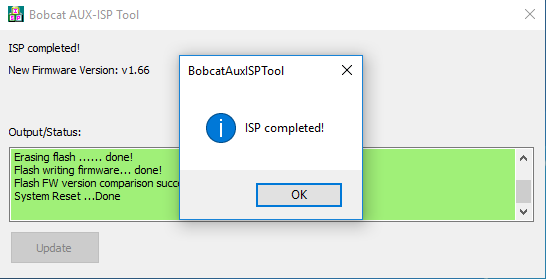

    4. [SOLVED] HDMI Firmware. If you are running HDMI firmware earlier than 1.66 you will have problems with the audio pass-through to an AV receiver that is HDMI 2.0 capable. After the update, which can be downloaded on the Intel Download Center, all audio formats should work fine.
    Intel states only to install this update when a HDMI 2.0 capable device is connected to the NUC. All my other devices are HDMI 1.4 and 1.4a so I think I have no possibility to install this update. Anyone experience with this update? Is it solving some of the audio pass-through problems? I managed to do the update to version 1.66. For installing this update, you need Windows 10. I created a "Windows to Go" version on an external USB 3.0 hard-disk using "Win2USB". Use the latest Windows 10 PRO iso. This can be downloaded at Microsoft. After that I started windows on my NUC booting from this external drive. The free win2usb can't create an UEFI bootable disk. So when you want to boot from this disk you have to go into the BIOS and switch of UEFI boot and you have to select the external USB disk as boot device under "Legacy Boot". Restart the NUC and go into windows, do the updates and start the HDMI firmware update utility. Despite all my devices, except the NUC are HDMI 1.4a I was able to update the HDMI firmware to version 1.66.
