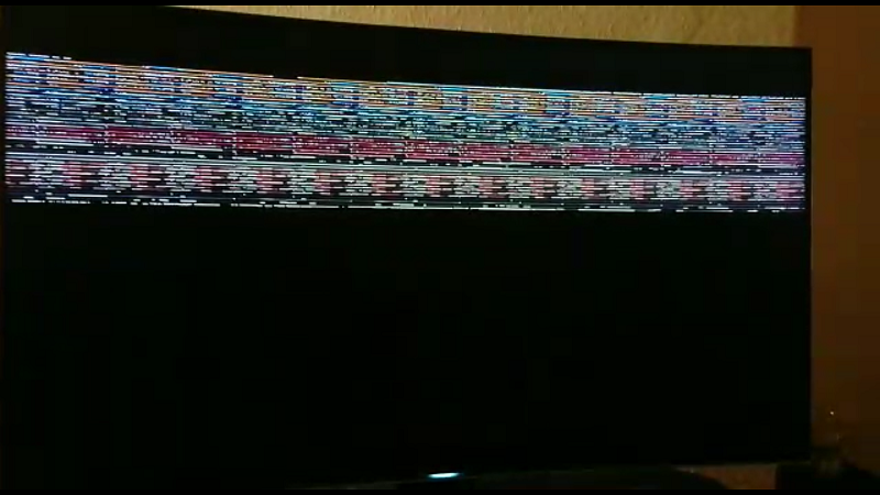

Try connecting to the box with SSH terminal and execute the following commands:fw_setenv hdmimode 1080p60hz
fw_setenv outputmode 1080p60hz
echo 1080p60hz444 > /sys/class/display/mode
Nothing,
Check cables. Use different HDMI ports.Nothing, :@. Maybe Kszaq knows.
I have a problem with turning on Libreelec on a new UHD TV. The logo of the box and Liber is displayed, followed by some rubbish on the screen. I checked this on another TV and everything is OK. I presume there is a lack of compatibiliy. Can anyhting be done to fix this? By adding some extra setups to the system or something. Please help.
