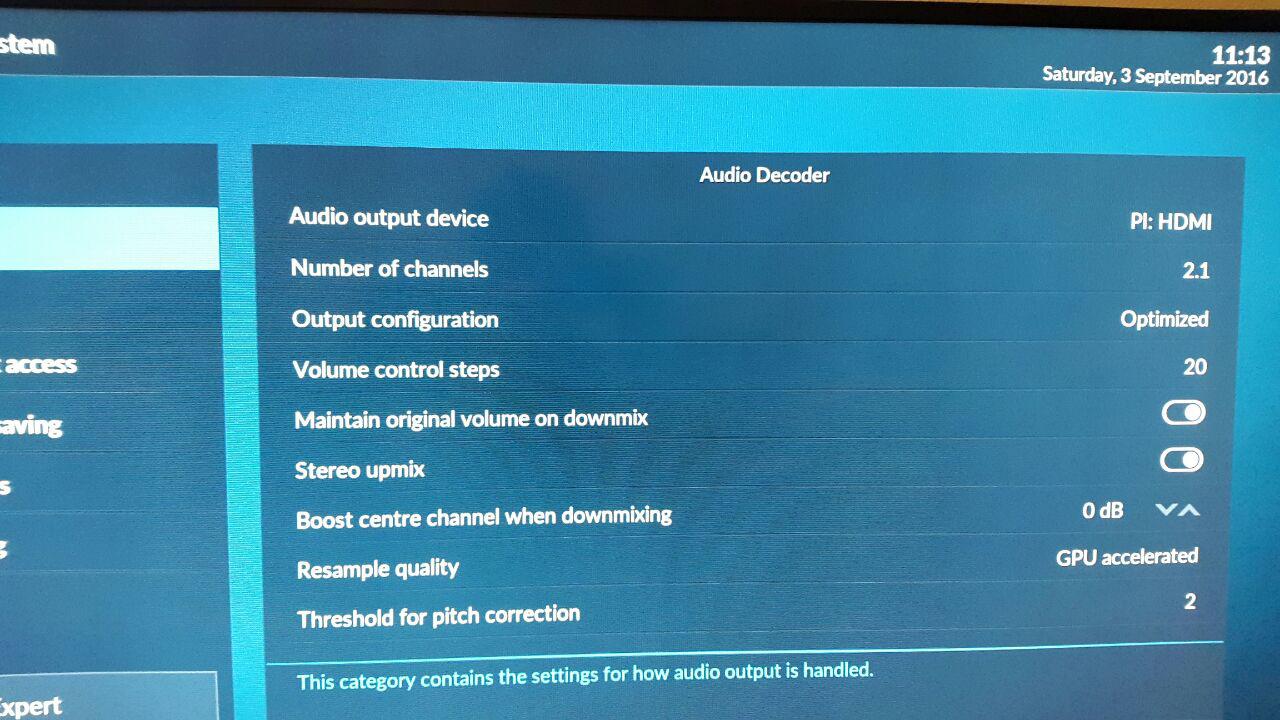

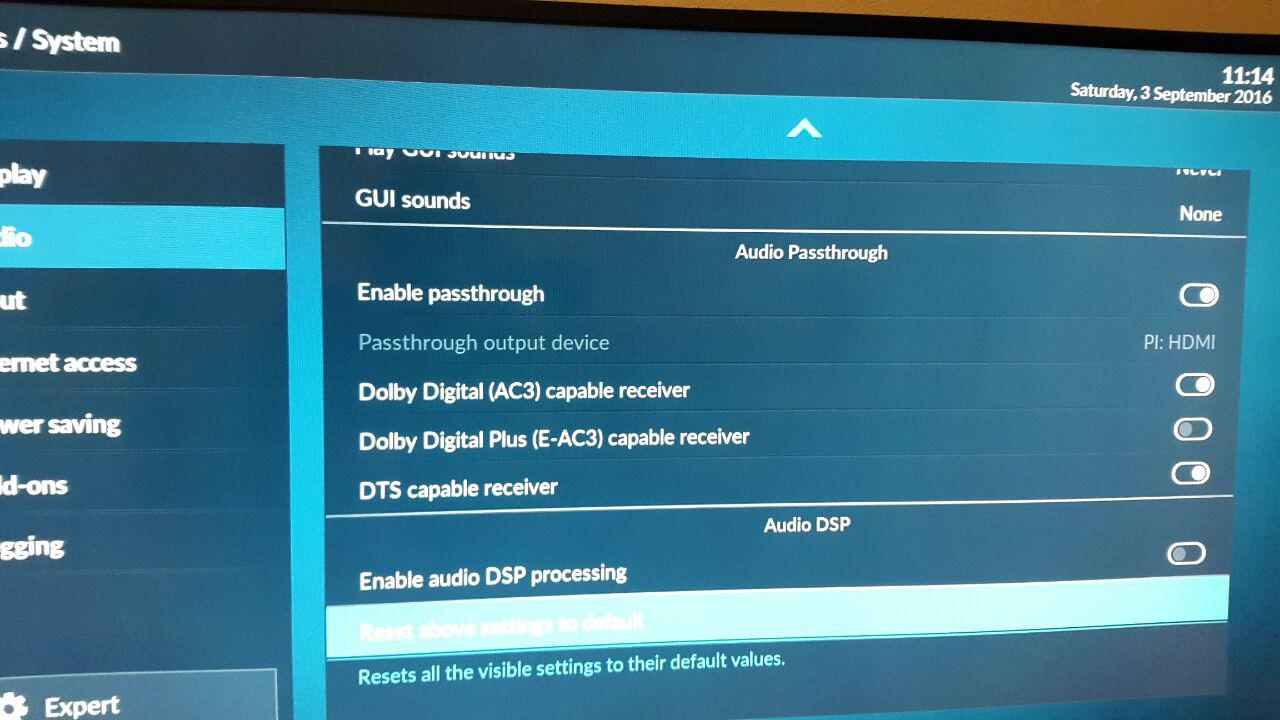

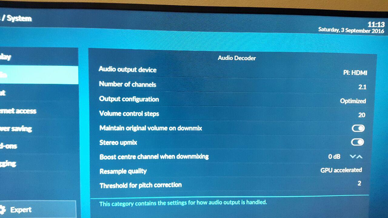

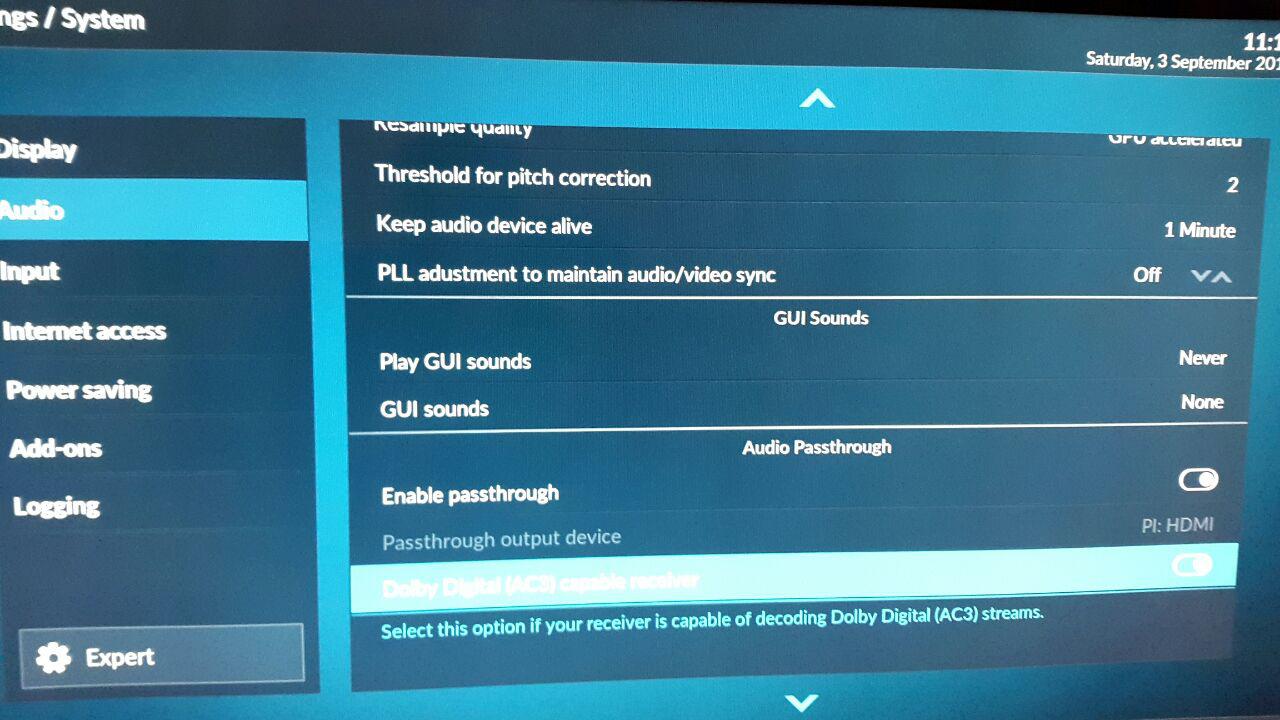

    I also noticed that the sound issue maybe a thing that you have noticed, since there are now settings like Threshold for pitch correction and PLL adustment to maintain audio/video sync?
    My RPI2 settings are the same as on my cubox except the new settings in 7.90.005 (and volume amplification due low sound, gpu accelration = high on cubox). Attached pics.
