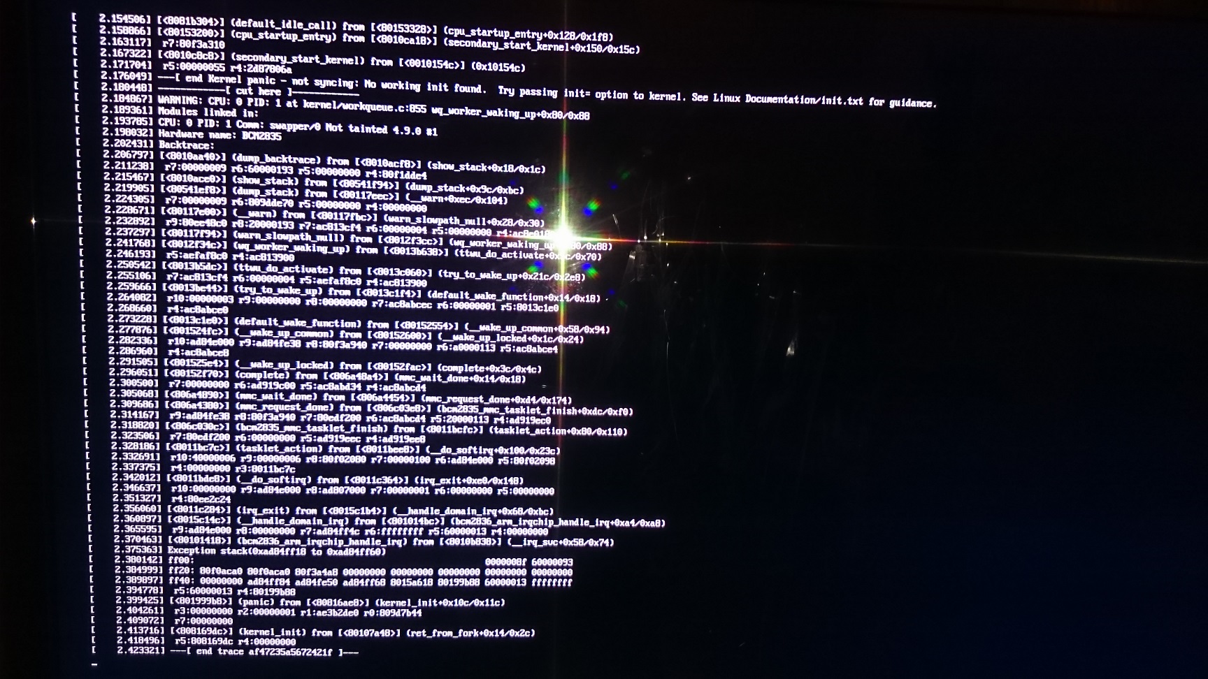

    I've just updated to today's Raspberry Pi builds (20161220) - I've got a RPi3. After updating from your previous build using the tar file, I get a Kernel Panic error when it reboots. I tried a fresh install from the img.gz file on a different SD card and I get the same error as soon as it's boots. Screenshot below...

    Looks exactly the same to me:
