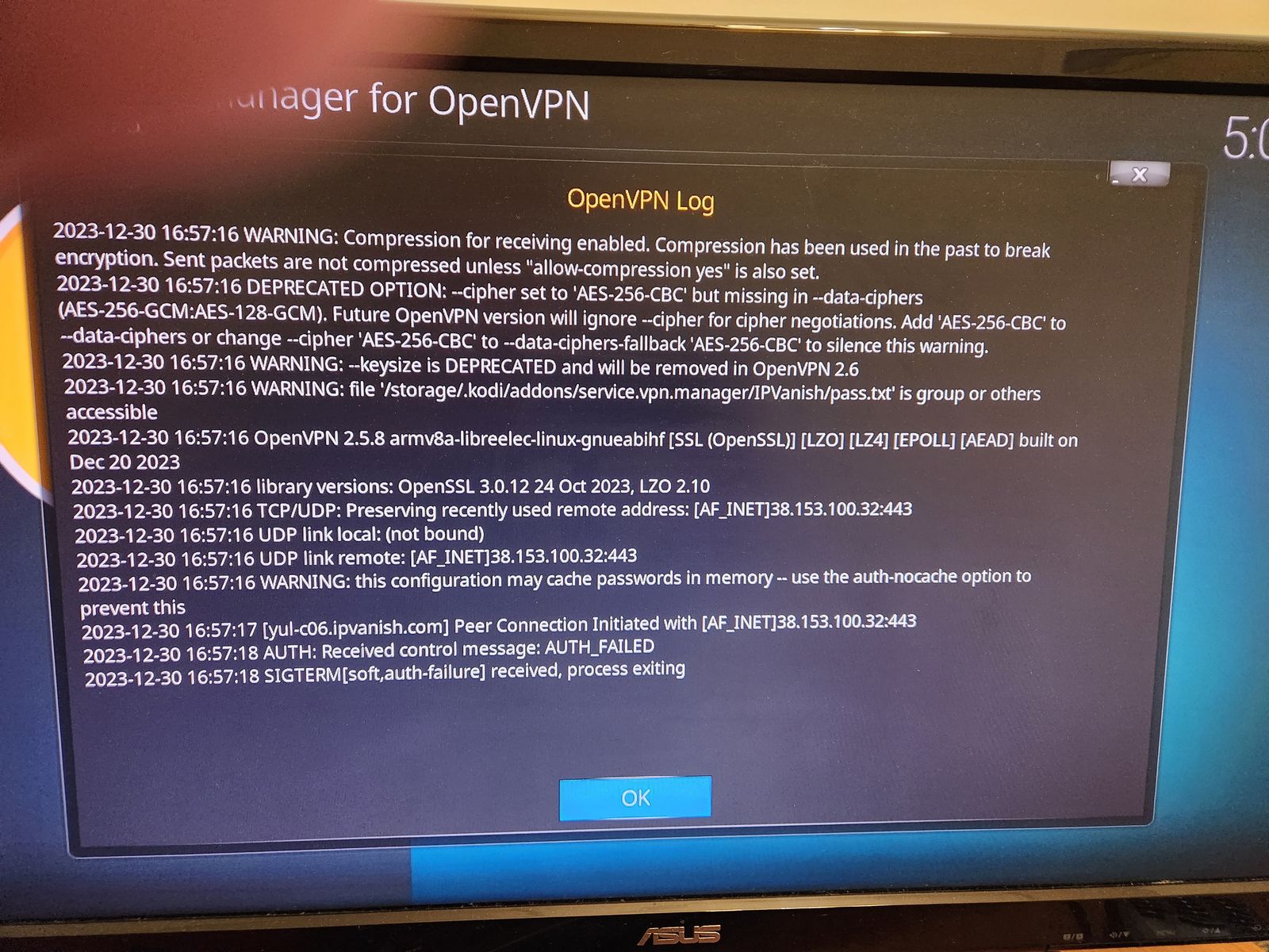

    I'd start with investigating the deprecated option warning which is related to ciphers; if those aren't aligned it will probably explain the authentication failure.
    I don't understand what a misalignment of ciphers means or how it yields a depreciated option warning and how, in turn, it would have an impact on the authentication. Or what ciphers are actually
    I do have a message out to the dev of the VPN Manager as well, but I found it odd that (according to their github) they have not had a new/updated release in the last 7 months. This just started a few weeks (maybe two months?) ago
    Thanks for your input, and yeah, I'm at the same thought that there will be no further development on LE9 and the only hope going forward will be for LE10
