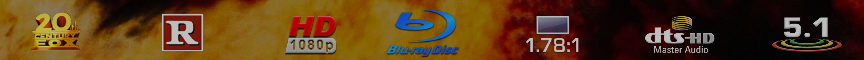

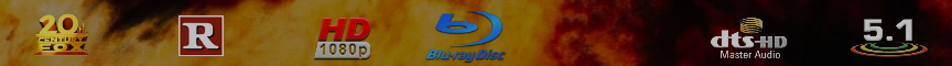

    I know kodi gets media info, audio & video statistics, from the video file when it plays. After upgrading to LE 9.0.2 I no longer see the correct aspect ratio of movies in movie info panel.
    Previous played movies show the correct aspect ratio, but after I play the video, and kodi update the video stats, I loose the aspect ration information. I see the correct aspect ratio when I select info when the movie is playing.
    Before:
    After:
    This happens with movies I have played before, so I don't think it's an issue with the file itself. I get the same result if I switch to a different skin. I am also loosing information about subtitles in the detailed movie view.
