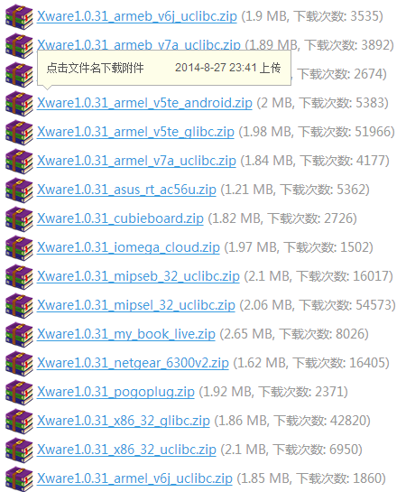

Can you provide a link to this addon so I can take a look at it?
yes, of course, but it is in chinese
http://luyou.xunlei.com/forum.php?mod=viewthread&tid=12545&extra=page%3D1%26filter%3Dauthor%26orderby%3Ddateline
in gernal, it is a software running on a router, NAS etc, providing remote download service. till now, there is only 32bit edition.
on rpi2, i use Xware1.0.31_armel_v5te_glibc.zip, and it works ok. -

HI, JoKe , you are right, it seems RPi use ld-linux.so.3, does it mean this binary can not work on s905? -
