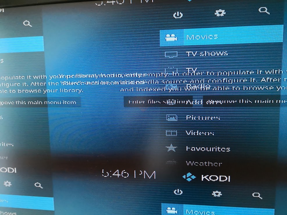

Isn’t your tv just set in 3D mode and splitting the image vertically?
