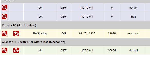

It's possible to connect both only if directly after System boot I'm changing fast
encrypted channels one by one, then dvbapi Client apper in Oscam Clients section
and everything works correct to next system boot. But If I'm not make this process
on beginning then dvbapi never connect to OSCam.

			2017/02/28 16:55:16 265ED022 c   (dvbapi) Client connected: 'vdr-plugin-dvbapi 2.2.3 / VDR 2.2.0' (protocol version = 2)Enyone know what is source of my problem?
