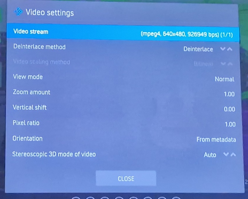

But then the older SD/HD content, mostly mpeg4 files i made back in the day from old tv recordings, will either show a solid green screen whilst playing the audio, or a screen with green/pink/purple washed out colors, with two duplicates of the image side by side on the top of the screen, partially obscuring the full sized image on the screen.

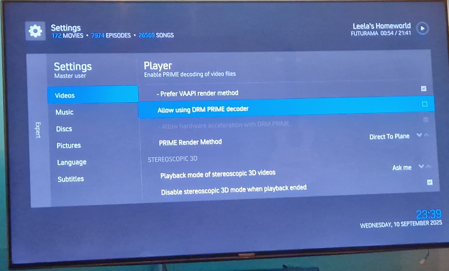

I have tried disabling and enabling 'Allow using DRM PRIME decoder (both with and without 'allow hardware accelleration' enabled, and with 'prefer VAAPI render method enabled or disabled. I have also tried turning off 'use MPEG-2 VAAPI' and 'use MPEG-4 VAAPI'. But whatever combination of these settings i use, it will either not play the old SD content correctly with the green screens, or it will not start HEVC 4K video.
