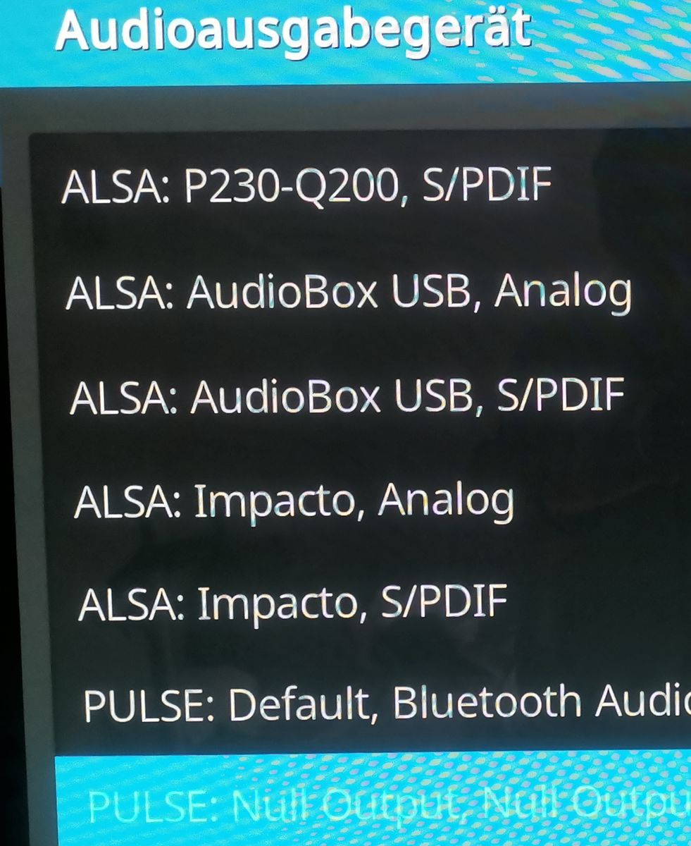

  • Hello chipfunk,
    I think i need support in getting the Usb-Dacs to work together with brutefir.
    Could you please give me some advice? The name of the Usb-Dac Alsa Devices are attached below.
    In the first place there is no need to operate brutefir with hdmi and usb-dac, usb-dac and brutefir alone would be perfectly fine.
    So maybe you can advise some concrete modifications of the existing standard hdmi setup?
    thanks in advance
  • Hi coleb,
    that's just the display-names for the audio-devices, not their identifier. Do you have the possibility to SSH into the machine and run
    aplay -L
    to find the proper device-id? Because that's the prerequisite for further steps. I think its a good idea to stop the BruteFIR-service before doing so.
    After you found the device-id for ALSA you can start editing the file /storage/kodi/addons/brutefir/bin/startup.sh from
    pactl load-module module-alsa-sink >> $PULSEAUDIO_MODULES_FILE
    to
    pactl load-module module-alsa-sink device="ALSA_ID" >> $PULSEAUDIO_MODULES_FILE
    to make pulseaudio take control of the device. That should give you a new PulseAudio-sink named alsa_output.ALSA_ID. You can run pactl list-sinks to verify.
    After that the output-section of BruteFIR-config has to point to the new PulseAudio sink, like so
    output "left", "right" {
           device: "pulse" {
                   device: "alsa_output.ALSA_ID";
    Restarting the service should play your audio on the new device.
    For more options on how to load PulseAudio-modules please see https://www.freedesktop.org/wiki/Software/…cedrivermodules and https://www.freedesktop.org/wiki/Software/…odule-alsa-sink.
    HTH
    Edited 2 times, last by chipfunk (February 10, 2024 at 1:15 PM).
  • It works!
    I added both USB DAC modules (device_id=USB and device_id=Impacto) to the startup.sh script :
    # Provide ALSA output
    pactl load-module module-alsa-sink device_id=Impacto >> $PULSEAUDIO_MODULES_FILE # Impacto
    pactl load-module module-alsa-sink device_id=USB >> $PULSEAUDIO_MODULES_FILE # AudioBox USB
    pactl load-module module-alsa-sink >> $PULSEAUDIO_MODULES_FILE # Hdmi
    now i can switch between the interfaces HDMI, USB Audio DAC and Impacto DAC via .brutefir.config:
