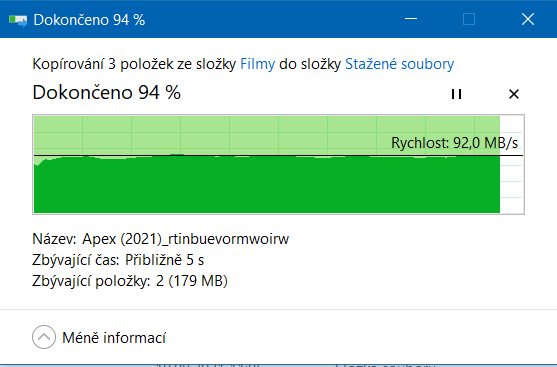

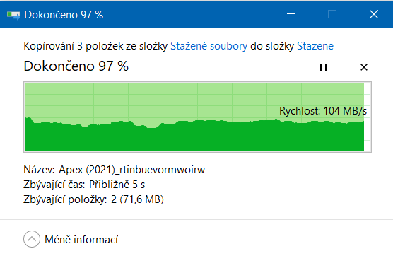

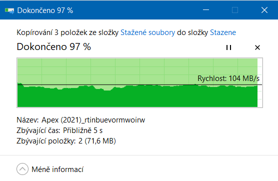

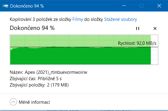

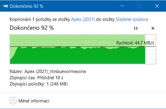

  • Hi, I need some advice.I have an rPi4. I have an external 1TB USB drive (formatted to ext4) connected to it, which I access from other devices using SMB (connected via 1Gb LAN). Until now, I have been running LE 9.2.8 on the rPi and everything has been without problems. After updating to version 10.0.1, I found that I have about half the read and write speeds. See the speed tests below.
    I did a clean install of LE 9.2.8 with default settings and ran a speed test (images below). The speed is about 90-100MB/s, which is the maximum speed of an external drive.
    Read speed
    Write speed

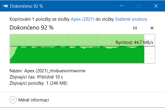

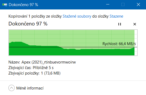

    Then I did a clean install of LE 10.0.1 with the default settings and repeated the tests. Speed averages around 40-50MB/s.
    Read speed
    Write speed
    I'm getting half the read and write speeds on the new LE version. The hardware around is the same, so it is some kind of SW problem in LE 10. Do you have any ideas on how to fix the problem? Thank you.
