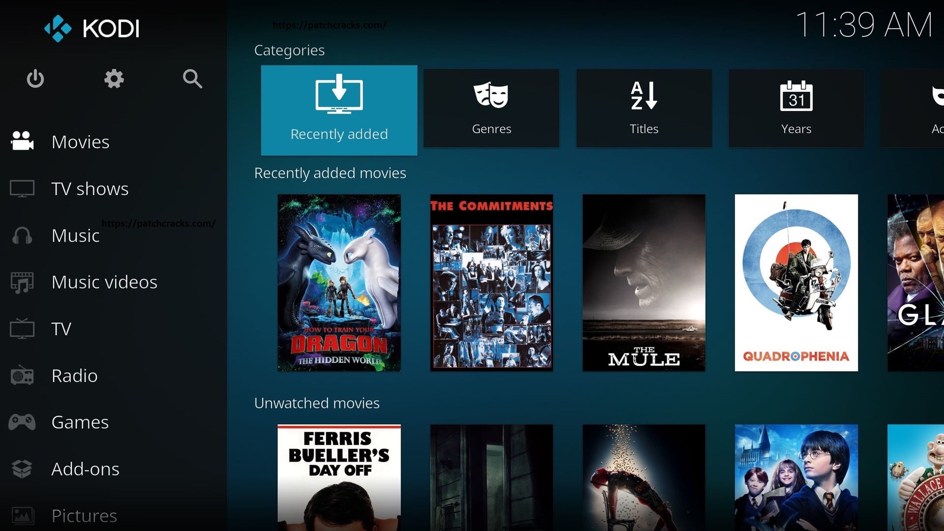

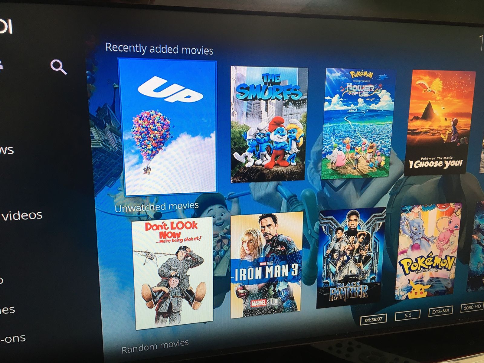

I have just installed a fresh install of Libreelec but the top bar is missing. Anyone know how I can get it back? It is there for Music but not for TV Shows or Movies
Categories bar is missing.

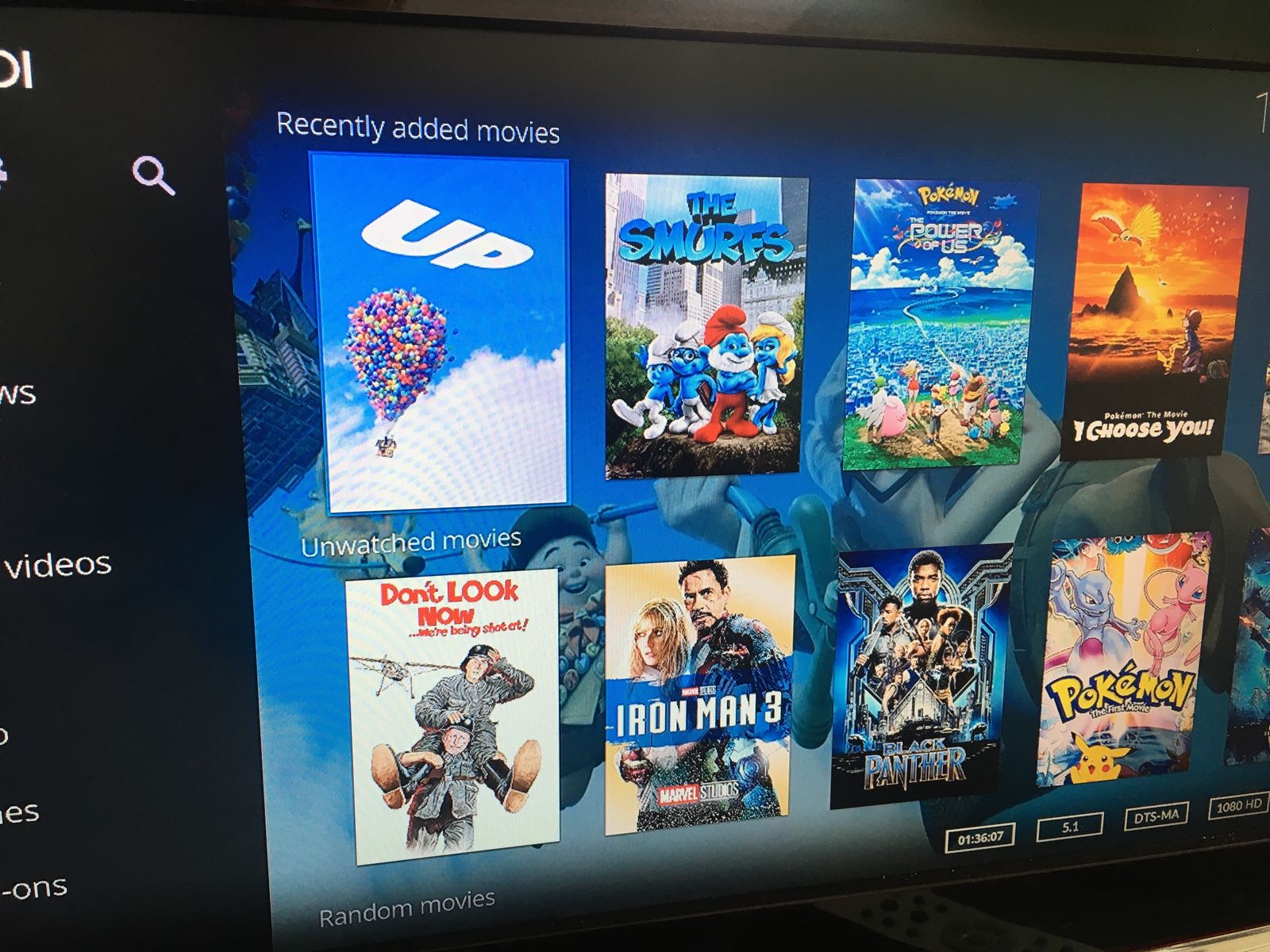

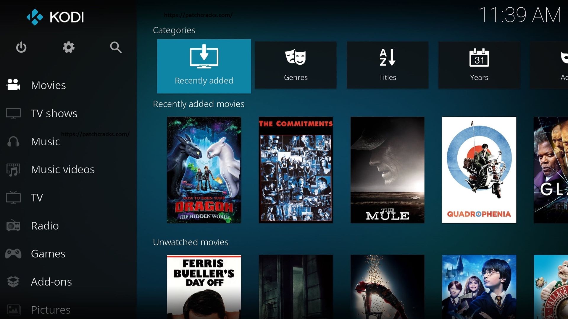

Before is what the second screenshot is. It shows the categories bar which is missing from my screen (the first screenshot).

Go to Settings-->Interface-->Skin-->Configure Skin...-->Main Menu Items.
There enable "Enable category widgets".
