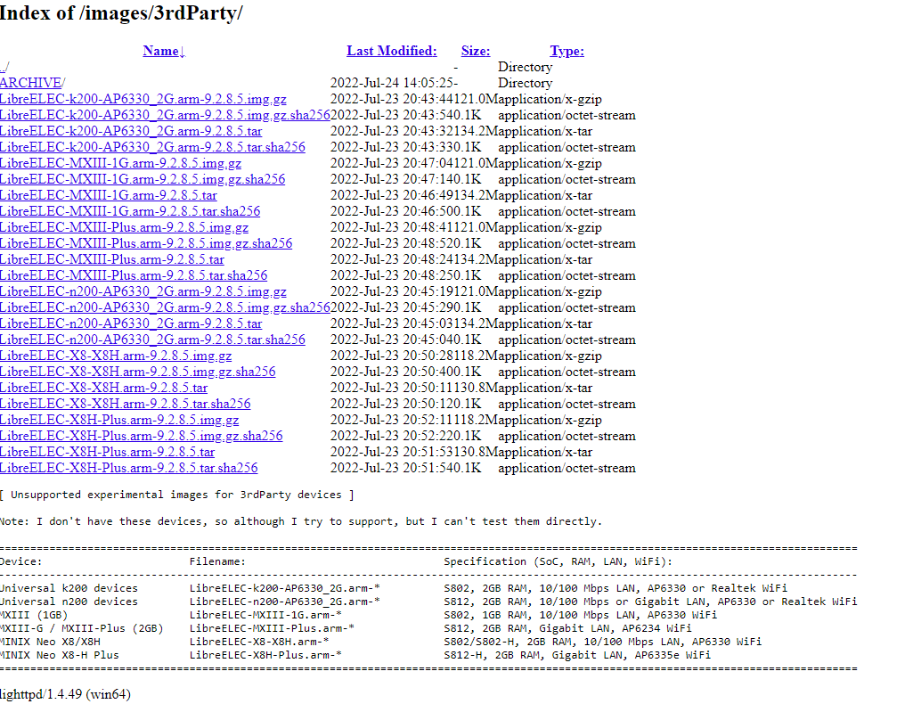

    I can't find the third party images on the github mirror.
    these appear on your site that is currently down.
    and I wanted to try to see which of them would go well with my tronsmart s89h, since I tried with the M8S PLUS but it does not raise the wifi or bluetooth.
    Could you pass me the link to download them or upload them to github?
    Thanks for all
  • these appear on your site that is currently down
    It is now available. There was an error with the ISP again. The simple reason: the "big fish" has acquired the "small fish" and now they are migrating the entire network to their own existing one. There have been problems for months, but they promise that it will finish soon.
    I didn't plan to upload the 3rdParty images to GitHub, because they need a lot of space together.
    If the server is unavailable, I recommend the Wayback Machine.
    You need to try the Universal k200 image on your box, with this remote.conf.
