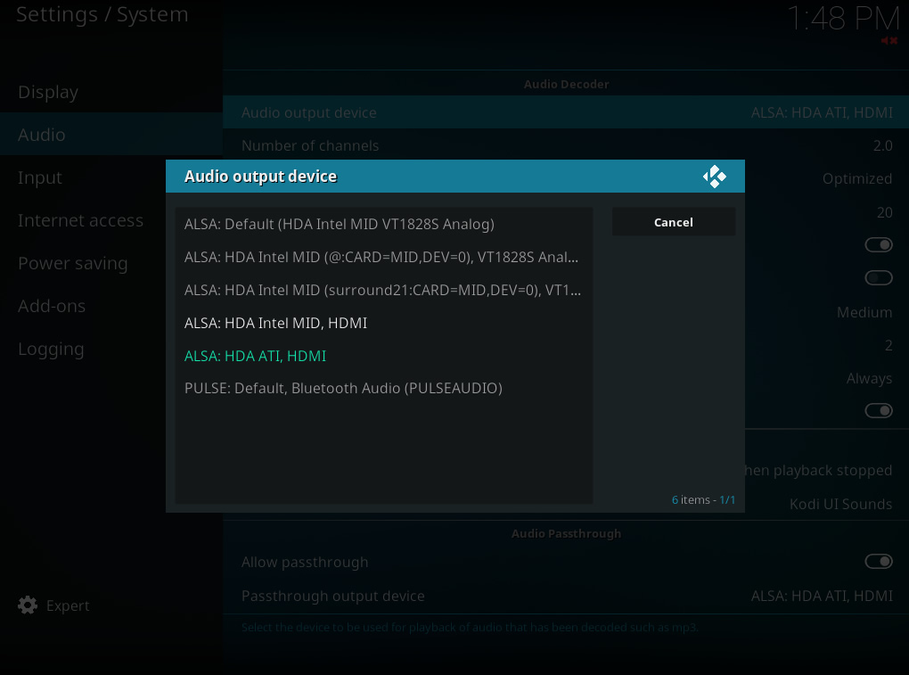

    I've tried all settings but cannot get any audio via HDMI when connected to a TV. Please see the screenshots for the current settings.

  • Thanks blueribb
    I don't have any other device to test which has HDMI inputs. I've checked the TV settings and there is no audio input settings for HDMI.
    I think it's hardware related as there is a red speaker symbol in the top right of the screen in kodi with a X so I think this must mean that there is a problem with the driver?
    I've looked through similar posts on the net and some people fixed it using a different lead which I've tried. Somebody else says to disable pulse audio but I don't think this can be done from LibreELEC?
    Do you know if there is a SSH command that will work with Libre that will show if the driver has been installed properly?
    Thanks
  • That red symbol may be MUTE. Try turning the mute off.
    if you are using a keyboard press f8 to UN-mute
    Edited 2 times, last by chewitt: removing video/link to the "Kodi help" site that encourages piracy use (August 6, 2018 at 10:04 AM).
  • Thanks very much it was muted. I pressed F8 and it now works fine. I was just about to try a different OS to run Kodi thinking that the card was incompatible! Thanks again.
