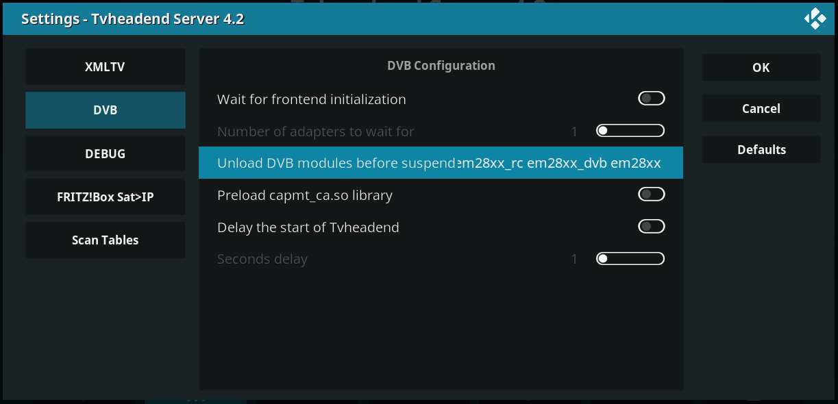

    Is the next step to paste these commands in to some config files (one to run as the system is going to sleep, one to run as it wakes up)?
    Thanks for taking the time to look at this, I really appreciate it!
  • I just added the three em28xx ones and tested sleep and then wake - and TV still works!! :)
    I will see how things go over the next day or so, but noted re: the other modules.
    Great work, thanks again!
