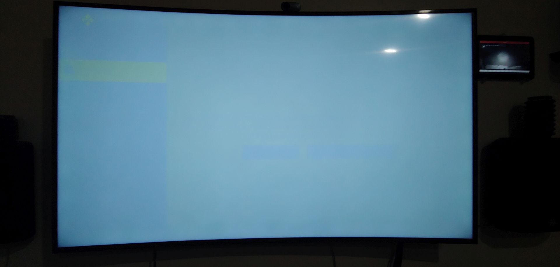

  • I created a bootable microSD card using Etcher, with this firmware >> LibreELEC-AML.arm-9.80-devel-20200107153635-6e9040d-amlg12.img.gz. I had been using CoreELEC on my Beelink GT King Pro, so I wanted to test this port.........
    Used this meson-g12b-gtking.dtb device tree. Used the paper clip to depress the reset button under the hole in the boxes housing...... The LibreELEC OS installed, but not useable at this time. The whole screen is light blue with the writing just a shade darker.........
    My King Pro serial number is 922 HHQ
    Any advice?
  • You need to add the u-boot.ext file to the SD card, then we chainload modern u-boot and avoid the weird colours that appear with Amlogic u-boot. Oleg has the file on his yandex drive. Don't expect all the video stuff to be working in the image .. because Olegs images appear to be based on my work in progress Linux 5.5 bump (which is work in progress, not complete).
