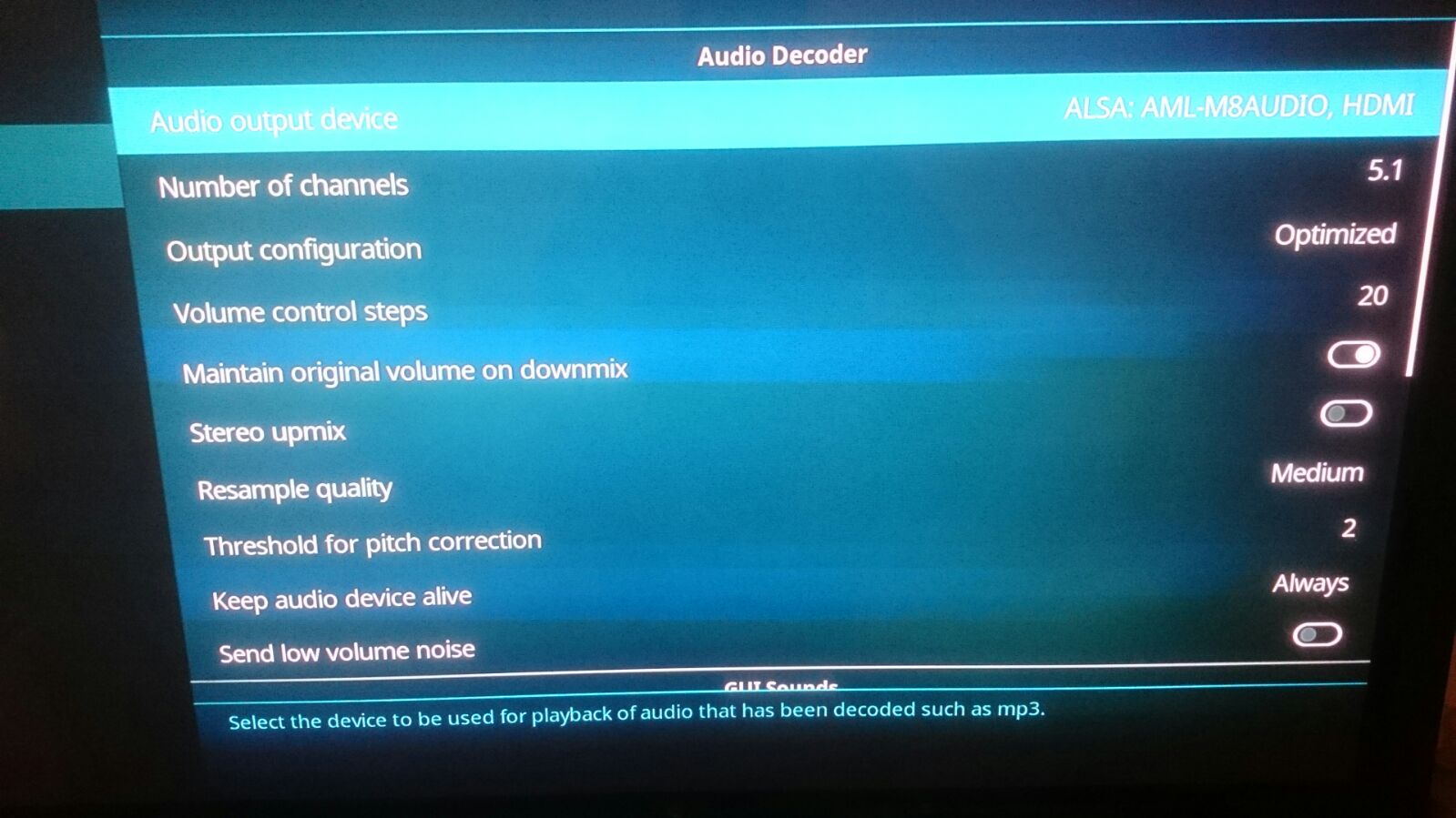

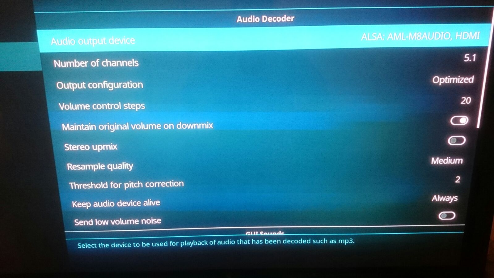

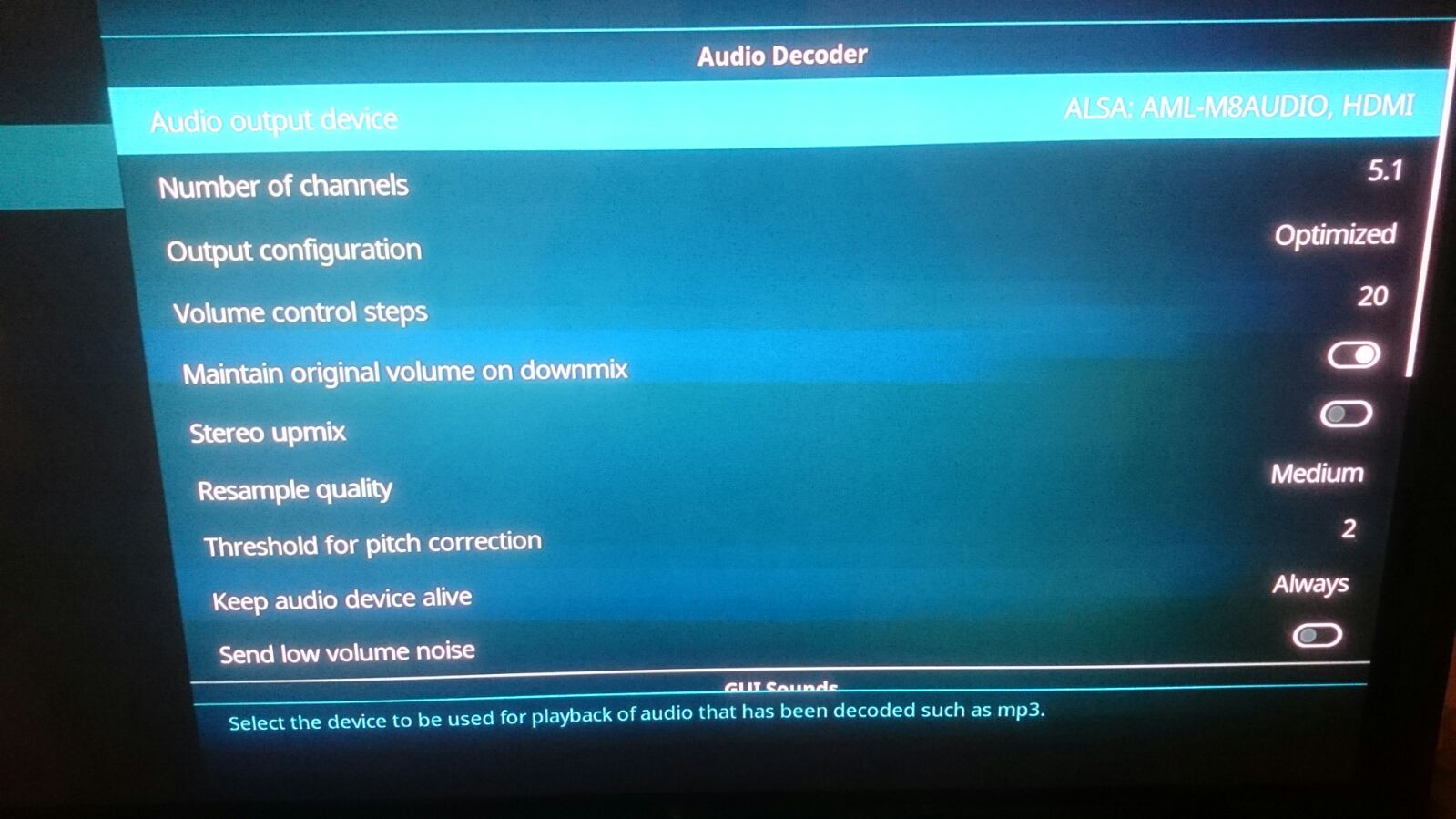

  • I can not seem to get any audio from the oDroid c2.
    Neither passthrough nor software encoded.
    if i view /sys/class/amhdmitx/amhdmitx0/aud_cap then the result is empty.
    it can not be hardware related, the receiver and cable are in pristine condition and functioning on my Raspberry Pi 2b. This box is meant to be to be a replacement for the Pi.
    The same settings are functioning fine on Pi.
    Im running LibreELEC-Odroid_C2.aarch64-8.2.5
    Is there something i need to configure / install ?
    Tried messing around with the passthrough settings and also tried without passthrough but no sound comes from the device. I've selected the HDMI as output device.
    Thanks in advance!
    Hardware:
    device: Odroid C2
    SD: Sandisk 64GB Extreme Pro UHS II (not new but using this until my nand arrives)
    receiver: Yamaha RX-V383 (which supports all codecs)
    cable: Hama HDMI 1.4 goldplated
    TV: LG 55 inch plasma (1080p)
    Adapter: A-grade 2500mah 5volt DC jack
    Some screenies from my settings page:
