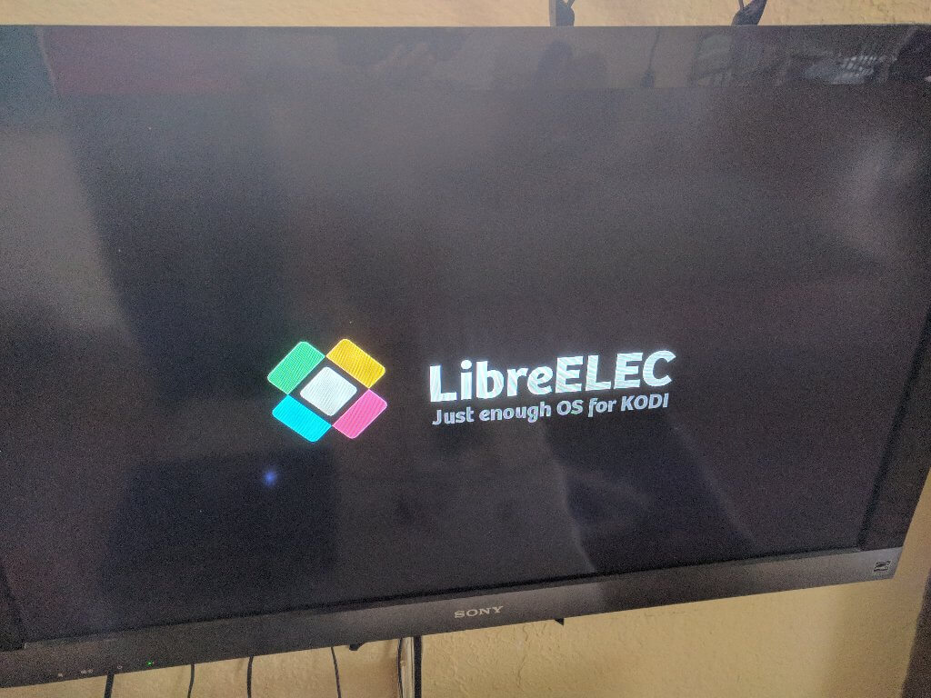

  • Hi
    Noob here tried to install latest on my odroid-c2. Installation went fine, used the usb creator tool on ubuntu. The sd card is a 16gb (not sure if that would matter). I can see the installation created 2 disks:

    When the odroid boots, I see the splash screen but that's it. Nothing happens. The lights on the odroid are solid red and blue, no flashing. Not sure what else I can do. I've formatted and re-written a few times. Is the any debugging I can turn on? nothing appears to be written to the disk after I reinserted into my PC I can't see anything changed. I don't even think the OS is booting. All help greatly appreciated!

  • So... got it working ... <sigh>
    I simply had to plug the sd card directly into my desktop instead of my Das Keyboard USB which is what I was using earlier.. now it just works fine, no problems..
