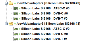

    I got both ATSC tuners working on my Raspberry Pi 3 running on a patched kernel 4.2.8.
    Raspberry Pi 3 has updated Raspbian from kernel 4.4.x to 4.9.x.
  • Hello. Nube here. Has anyone been successful getting both tuners working yet? ATSC for both?
    Yes, I got both ATSC tuners working for my Raspberry Pi 3.
    I extracted the patch file for kernel 4.2.5 from Dropbox - wintv-dualhd-kernel-4.2.5-2016-08-10.patch.tar.xz
    I used the instructions to apply the patch from Kernel building - Raspberry Pi Documentation
    After rebooting with the patched kernel, the two ATSC tuners appeared.
