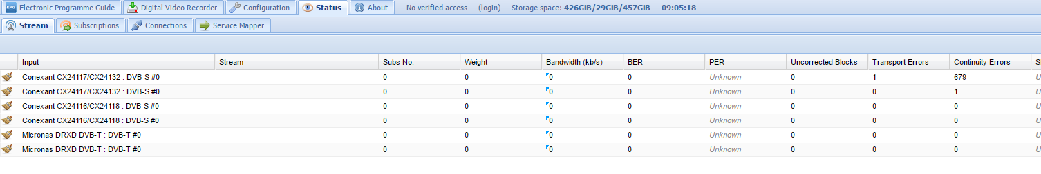

  • I seem to have sorted one issue but I still get continuity errors on the TBS 6981 card, my two Hauppauge Nova S2 are fine. I did read that there are problems with this card and the discussion about it being possibly a driver issue. Is there any way of installing the Crazy cat or open source driver on Libreelec 8.0.1
    Thanks
